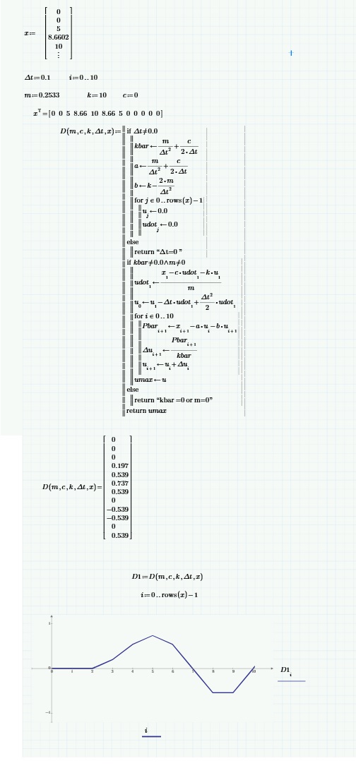

Hey guys,
I'm Laura and im currently working on a worksheet in mathcad Prime 3. The first time programming and having a hard time trying to compute a rather simple loop for an explicit time-stepping (numerical evaluation) problem. For those who are familiar, it's the book of Chopra-Dynamics of structures ->chapter 5, p. 207,  Central Difference Method
If someone could help me out, tips making the program work, that would be greatly appreciated!

Hi Laura, now it seems that everything is fine.
Greetings
FM

Hi Laura,
there are a couple of issues with the worksheet,
The first, in the program is that you try to reference u[-1; the origin is either 0 or 1 - so this variable does not exist.
Too fix this I have added 1 to all the references - it seems to work but will need to be checked & tidied up
The second issue is with the plot.
the index variable needs to be written as a subscript & the function needs all the parameters.
Attached is Prime 2 version.
Hope this helps
Andy

Hello Laura, since there are enough other files offered by the community, I'll show only a photo of your problem solved by me, from which you can take whatever you need.
Cheers
FM
Dear FM,
It is very kind of you responding that fast. Thanks a lot. However, unfortunately, when I compare the results of the example presented in the book of Chopra and those that are derived from the program I don't get the same answers. I highlighted the differences in green. I hope you are willing to take a look at it.
Hi Laura,
I haven't managed to reproduce the results here (yet), but I think that you need to compare the program against the book you are following.
So far I have noted that:
the x (p) input appears to have an additional 0 at the start.
c is defined as 0 in the program but 0.1592 in the book example.
the definition for a in the program is
but the book says
None of the above significantly affect the calculation, but it does suggest that  there are further corrections to be made.

-MFra-21-Topaz IIAnswer
Greetings
FM
