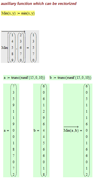

If I have two vectors each with one column and 15 rows and I want to take the minimum of each row of the two vectors and make that a new vector is that possible?

Sure David,
Here's a solution.
Now instead of the two fixed vectors, you can call MinRow with any set of vectors you like: MinRow(FirstVector, SecondVector)=...
You will get an error if the length/size of the vectors are unequal.

May 12, 2014 8:48 PM UTC
min() cannot be vectorized, otherwise it would be a oneliner.
But we can define an auxiliary function using min() which then can be vectorize and does the trick without programming.

May 13, 2014 12:14 PM UTC
Thanks for the quick replies!! Both solutions work great. Since I am not very savy with programming or with using functions that are not on the basic toolbar I really apppreciate the help. I do have another question related this topic.
