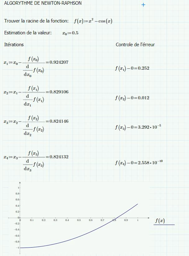

I need to use Newton algorythm with prime.
I write algorythm  step by step.
I don't know prime correctly  to make a program for iterative loop.
I need to make 10 loop max, and i want to program break when:
- iterative loop over 10
or
- Error control match with range value Ec
I need to enter manualy first step x0
I need to enter nanualy Error_control Ec
Please, can you help me to write NR with program in prime.
in this capture:
find root for f(x) function with NR algorythm

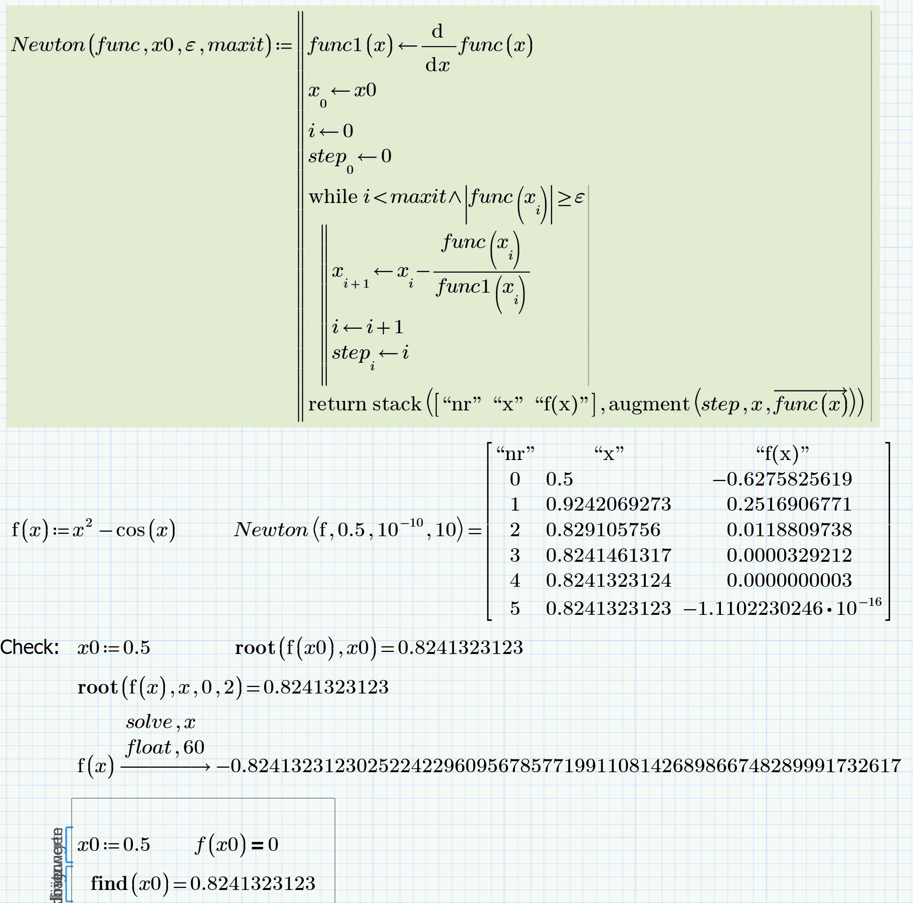

Here's a slightly different function with two additional arguments - function and max.iterations - and a table as output:
Worksheet in P4 format attached.

Werner_E25-Diamond IAnswer
Jul 31, 2018 12:13 PM UTC
XDN14-AlexandriteAuthor
Jul 31, 2018 12:23 PM UTC
It's ok for me !!!
Thanks!!!!
For my use, it's not necessary to iterative loop is "var"
ten value will be implemented in hard.
But it's more pretty in your solutionSmiley Wink
