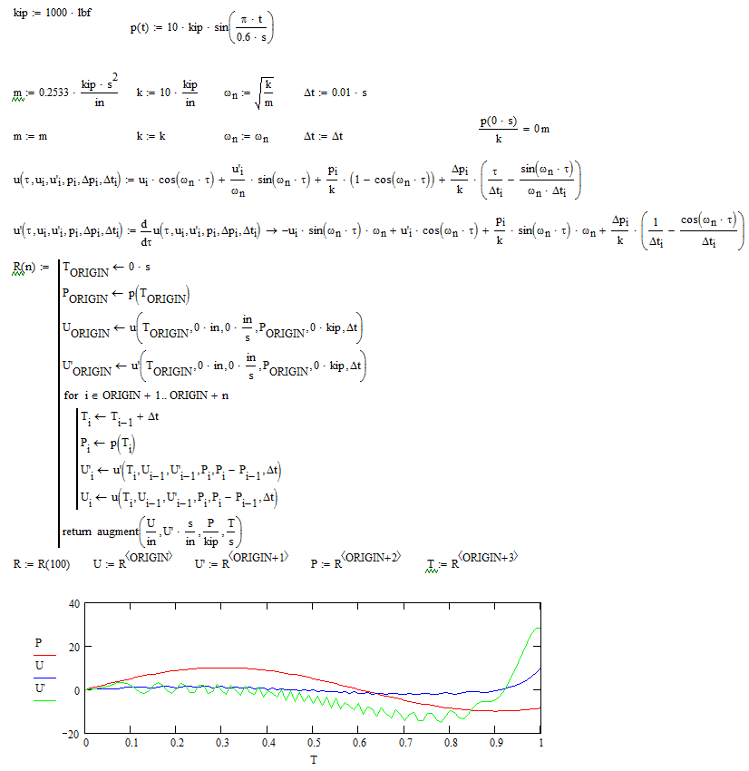

Something like this?
This was done in Mathcad 11. I can't use Prime (3.1) for this, because I'm limited to Express (No programming).

January 13, 2016
You wanted to "Help me to programming the numerical method", which I think I did. And you were able to replicate what I did in Mathcad 11 into Prime 3.1.
I think it's up to you now to change the formulae to your more detailed need, and get the results you want.
If you then run into specific problems, don't hesitate to come back for help.
