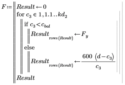

I am trying to program a series of iteration in mathcad, and i can't seem to program the part that I needed to get a good result. Can someone help me proofread my program?
my dependent variable is c3 = 1, 1.1, kd2 that will be programmed to 2 different set of rules,
if c3<cbal , Fy and if c3>=cbal , (600(d-c3))/c3
My F(c3) and Mcr is not showing a result of array. I am confused where to put my index that will support my array function. Kindly help. Thank you.

I am not sure what you are trying to achieve.
If you expect a return vector of 2601 values, you could do it that way
No need to provide the local variable c.3 as function argument.
But you let c.3 run up to kd.2=261 so the condition c.3<c.bal is always true and you get a vector with 2601 entries being all the same (F.y=275).
Is this really what you expect?

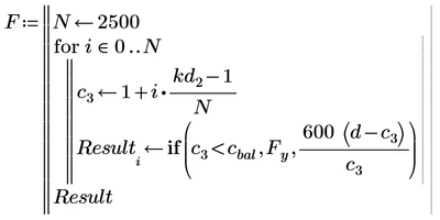

BTW, here is an alternate way to create a vector F, this time not using a fix step of 0.1 for c.3 but the range from 1 to kd.2 is divided into N steps

how do you put Result rows(Result)> is it (ctrl -)?
Well, I wanted it to produce an array at my Mcr if the function goes otherwise.
No! Its a vector index ([). This is a convenient way but only works OK if ORIGIN is at its default value 0.
The first time rows(R) returns 0 because R is not an array but a single scalar. So the first value is now saved in the first entry (#0) of the vector R.
If ORIGIN is set to another value, you would have to use  R [ ORIGIN+rows(R) instead of just R [ rows(R)
Nonetheless I would prefer the second method shown where you have more control over the number of entries in the vector and also can assure that the end value kd.2 is actually reached.

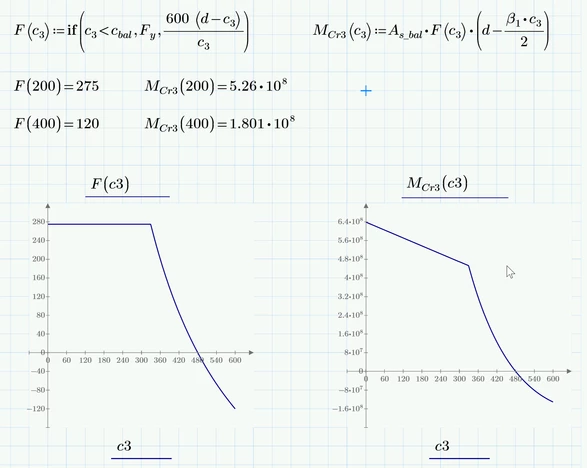

In the meantime I had edited my post and attached the worksheet in Prime 6 format which seems to be the version you are using.
