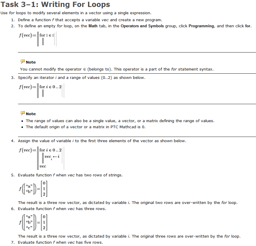

I have a very basic question. the for loop example in programming tutorial task 3-1 for prime 3.1 does not work as stated. What is wrong?

The German help is broken in my installation, too. I often don't see any pictures. Switching the language of the help to English cures that problem - c*r*a*p!. Looks and feels like a program written by a few unexperienced highschool youngsters.
Here is a picture of that page:

We don't see what you have done and you don't explain in which respect that program does "not work as stated". So we can hardly explain whats wrong.
Maybe you changed the value of ORIGIN from default 0 to 1 - this would make the program fail with an error.
Otherwise we would need more information and at best the worksheet you created as attachment.

A possible common error is using literal subscripts (Ctrl+-) instead of a matrix index ([).
ruddin1-VisitorAuthor
March 16, 2017
That is exactly what I did. Is there a manual for prime 3.1. There is a lot left unsaid in the tutorials.
