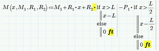

The definition of your function M has errors, too: There is a multiplication sign missing after R2 and in the if statements you have to assign a unit to zeros, too (dynamic unit checking in Prime vs static unit check in Mathcad).

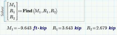

In the solve block you have to put find() at the end as in the Mathcad version to tell Prime what you want it to do. You may do exactly as in MC15 using a variable Result or you may directly assign the output of Find() to a vector consisting of the three variable names.
