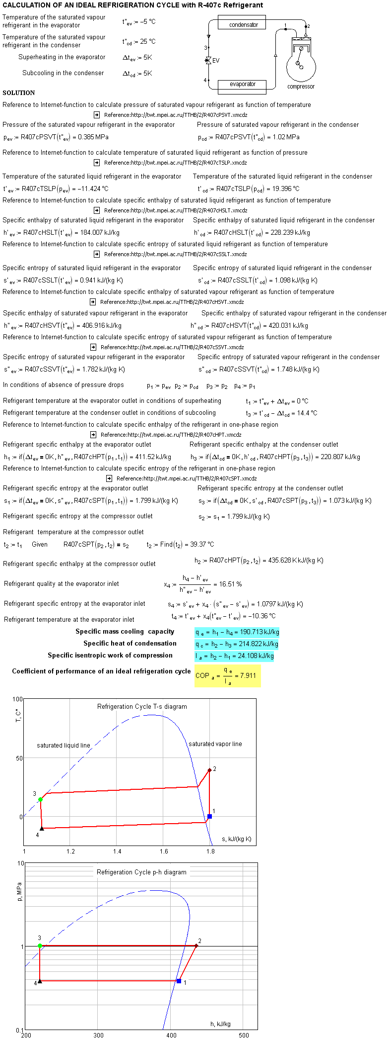

If You insert References on this cloud functions of the thermodynamic properties of this refrigerant you can calculate for example an ideal refrigeration cycle.
Try the on-line calculation on Mathcad server - http://twt.mpei.ac.ru/MCS/Worksheets/PTU/RefrMachine-en.xmcd
See the sheet in attach and the picture
