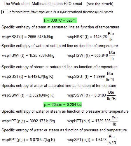

If you have this functions and some others in your sheet you can calculate for example one Thermal Power Cycle:

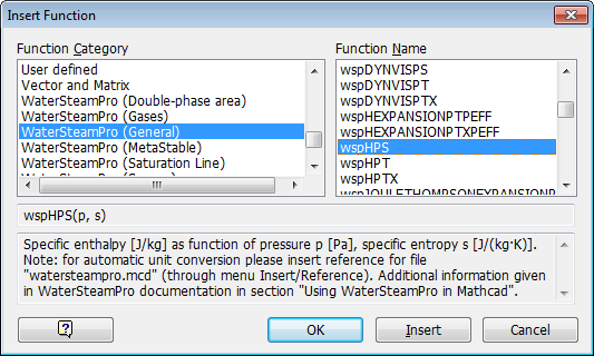

Can you show us how do you use this link?
Now we can do in Mathcad 15 a shorter link:

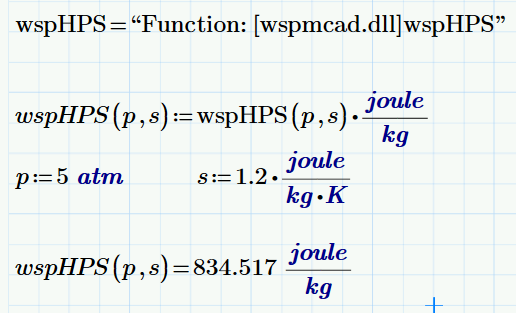

Hi Valery
Would it be possible to get a function for specific enthalpy, as function of pressure and specific entropy?
Best regards
December 7, 2016
See please www.wsp.ru
Mathcad 15
Mathcad Prim  3.1:
Or (Mathcad 15) free of charge for students by using cloud functions
December 7, 2016
Hi Valery, thank you for your attention.
I have installed WaterSteamPro on my PC, and I it works in Mathcad 15, but I can't get the it to work in prime. I have copied the "wspmcad.dll" file to the custom functions folder in Prime. However that does not seem, to do the job. I'm probably doing something wrong? I am on 64-bit system.
Is it possible that you could upload a mcdx. file, with HPS- function. Similar to the ones you have already uploaded.
This would be a huge help in my studies as a marine engineer.
Thanks in advcance

December 8, 2016
Hi Valery
I will be looking forward to 64-bit version.
Thank you for your attention
December 9, 2016
OK.
With Prime 4.
