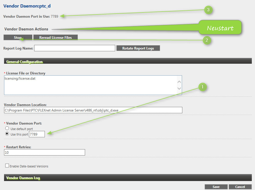

We've been upgrading our servers and now I need to move the licensing for Mathcad Prime 3.0 as well.
The new server is a Windows Server 2012 r2 and I'm trying to install lmadmin 11.11.1. (Same error with lmgrd 11.11, 10.8 both manual installation and setup)
The lmadmin installer just reports the server as unreachable, but looking through the logs show this (same behavior & error as other versions tested):
lmadmin.log
2016-02-13 14:56:26,488 root Version: 11.12.1.1 build 148864 (2014.04.25-04.26.06)
2016-02-13 14:56:26,488 root.LicenseEngine started without redundancy.
2016-02-13 14:56:36,609 root.Vendor (ptc_d) stopped.
2016-02-13 14:56:36,609 root.LicenseEngine (ptc_d) exited with status 28. (Communications error)
2016-02-13 14:56:46,781 root.Vendor (ptc_d) stopped.
2016-02-13 14:57:06,970 root.Vendor (ptc_d)maximum number of start retry is reached.
ptc_d.log
14:56:56 (ptc_d) Using options file: "C:\Program Files\PTC\FLEXnet Admin License Server\licensing\ptc.opt"
14:56:56 (ptc_d) Server started on FILESERVER for: 254
14:56:56 (ptc_d) 255 256 257
14:56:56 (ptc_d) MATHCAD
14:56:56 (ptc_d) EXTERNAL FILTERS are OFF
14:56:56 (ptc_d) ALL FEATURES: INACTIVITY TIMEOUT set to 7200 seconds
14:56:56 (ptc_d) Report log started (+C:\Program Files\PTC\FLEXnet Admin License Server\logs\ptcreport.log).
14:57:06 (ptc_d) Vendor daemon can't talk to lmgrd (License server machine is down or not responding. (-96,491))
14:57:06 (ptc_d) EXITING DUE TO SIGNAL 28 Exit reason 5
I have added the required rules to the windows firewall (by now a bit more then required), TCP 7788 in/out, lmadmin in/out, ptc_d in/out, lmgrd in/out, going to clean it out when i get it to work.
Looking at the license.dat file all licenses, paths &  seems fine and HOST ID and server name is a match.
I've been trying everything I can think of (specified port for ptc_d and matched firewall rules, manually installing everything according to instructions, tried different versions) and has searched for an answer but have found none where it wasn't the firewall. I've tested the firewall for port 7788 by configuring another software to listen to the port and it was reachable.
Would appreciate any insight you might have.

February 18, 2016
It started working. I have no idea if below described procedure actually helped or if it was blind luck.
After reading a lot about other vendors installations using lmadmin I created the directory <lmadmin install directory>\licensing\ptc and copied ptc_d.exe and ptc.opt to that directory, for good measure i also copied ptc_d.exe to <lmadmin install directory>\licensing.
This should have no effect without changing the DAEMON line in license.dat, then I restarted the lmadmin service (I wanted to trace the log output).. and suddenly it worked. Other then that I have not changed anything else.

March 14, 2016
Domen,
I also opened a case with PTC tech support.  We found that I had two licensing services installed, lmadmin_ptc and PTC FlexNet.
I am not sure how both got installed, whether it is by default or if I screwed up .  lmadmin_ptc is a Web based license manager, PTC FlexNet the familiar lmtools.  I did not want to use the Web service license manager so we disabled lmadmin_ptc.  (The naming convention seems somewhat counterintuitive to me...)
So, check the services running on your license server.  If you have BOTH lmadmin_ptc and PTC FlexNet running, you have to disable one of them, and make sure all the configs are pointing to the correct paths for the other.  (PTC FlexNet is the old familiar LMTOOLS and is what I wanted to use.)
It has stayed up and running for over an hour - I will update if I start seeing errors again.
Joanna

February 6, 2018
FYI,
in https://www.flexsim.com/ftp/LicenseServer/FlexNetPublisher_Docs/fnp_11.14.0_Rev01_RelNotes.pdf document, there is following information:
To use lmadmin on Windows platforms, the Microsoft Visual C++ 2008 Redistributable Package (x86) must be installed.
I installed:
https://www.microsoft.com/en-us/download/details.aspx?id=29
Microsoft Visual C++ 2008 Redistributable Package (x64)
https://www.microsoft.com/en-us/download/details.aspx?id=15336
and "ptc_d exited with status 255" problem was resolved (in Windows Server 2008 R2 Standard SP1 64-bit).
