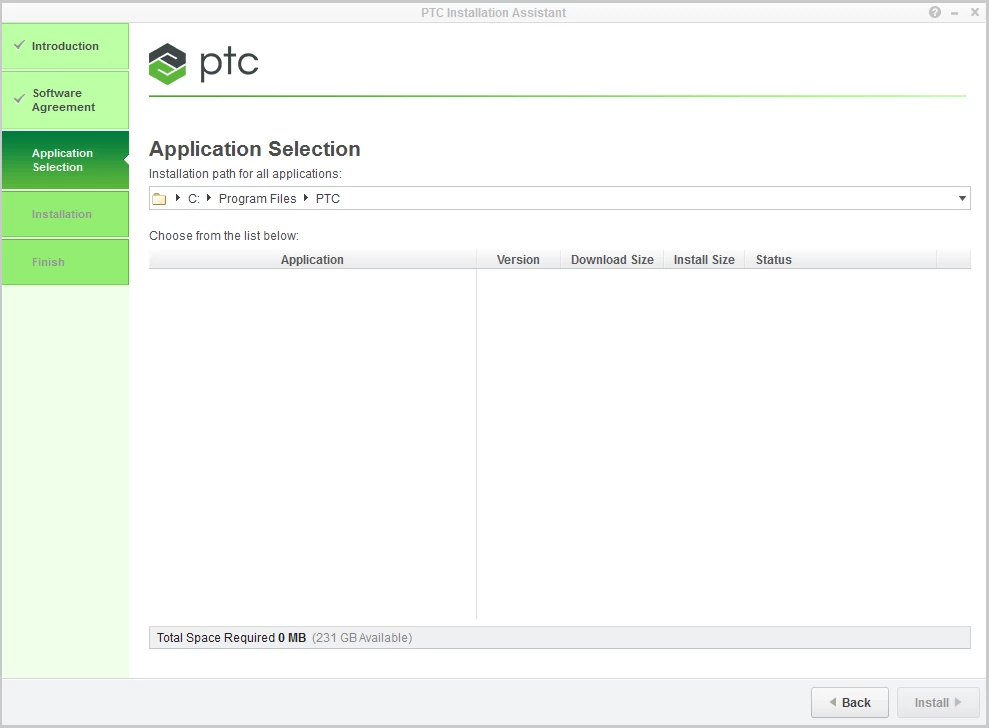

I am trying to install MathCad 4.0 but after downloading the file, starting the installation assistant and agreeing the software agreement I am unable to proceed any further. No options come up for me to choose so I can't install the software. Any advice would be grateful 🙂

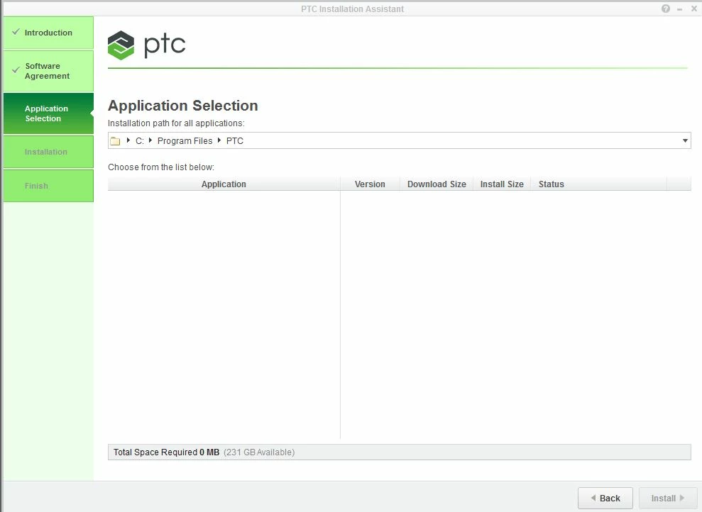

Same Problem for me. I tried to install the "Express"-Version of Mathcad in a with several pupils. Some installations/pupils have the same problem: There ist no option to choose from (like shown in the screenshot)
Here are some further information that might help:
- We used the "pim_installmgr_mathcad" installer (22mb).
- None of the pupils had installed Mathcad before.
- Different Windows Versions (10 Home, 64/32 bit) are used.

I think he refers to the pictures, which scottytwee posted in his initial question.
