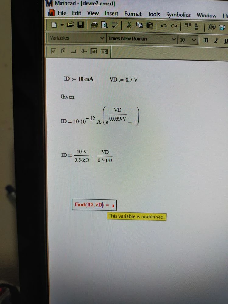

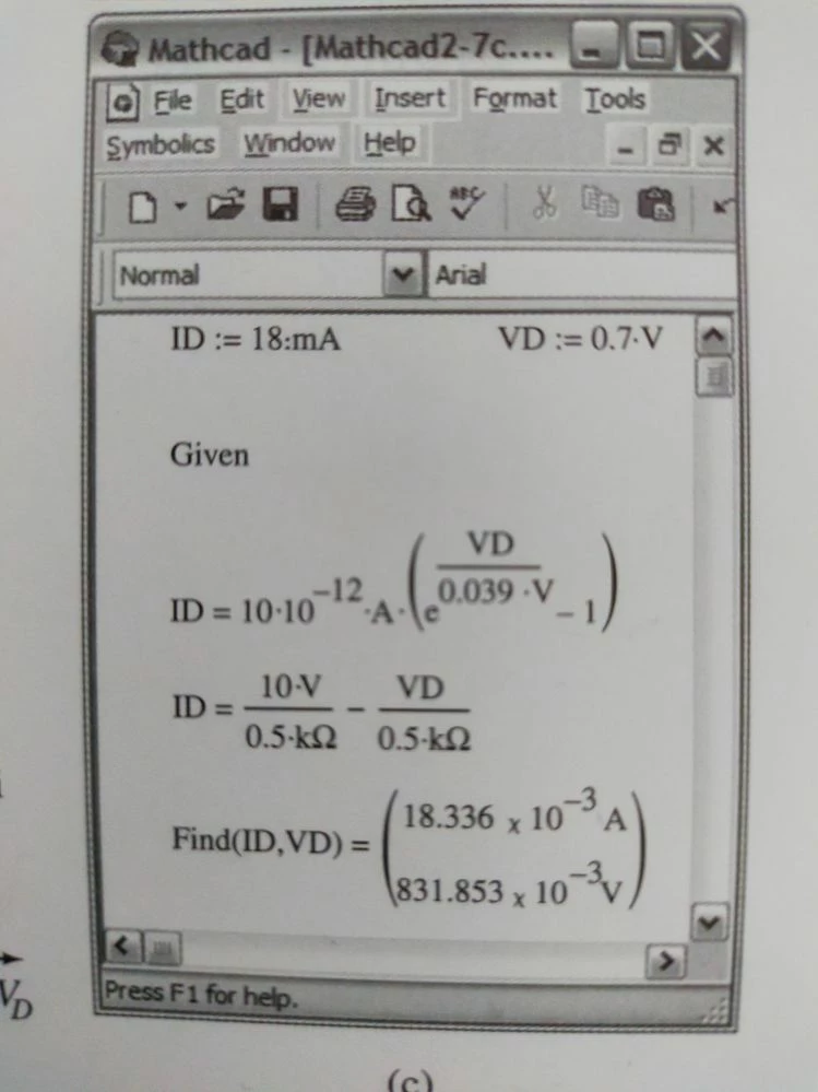

Dear Friends, I am using Mathcad 15. I use electronic books. The book has the solution of the system of equations related to Mathcad 15. However, I cannot solve the formula system even though I do the same. I'm getting an error.
I'm posting screenshots from the book and my own implementation.
I am also attaching the Mathcad file. I'm waiting for youExample in the bookExample in the bookScreenshot and error that I implementedScreenshot and error that I implementedr help.

Your VD in the second equation, above the 0.5 kOhm, is labelled as a constant, instead of as a variable.
The problem is SUC (static unit check) in Mathcad 15
Delete the evaluation after the Find command and assign the result to a vector with two variables to get the desired result
The E-Book was written for a very old version of Mathcad which did not use SUC. This old version allowed the display of a vector/matrix which contains quantities of different dimensions (voltage and amperage in your case). Mathcad 15 does not allow for this and the error message unfortunately is misleading.
See attached sheet
