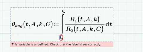

You mean this:
Well, neither t_sub_a nor t_sub_b are defined above or to the left of the definition of this function.
Where did you (think you) defined them?
February 20, 2019
no  i mean this one
February 20, 2019
You try to symbolically evaluate a function that is traceable to a function that includes a branch (Phi and F).
You can't symbolically evaluate/display a function which includes a branch (if-function or if-statement).
