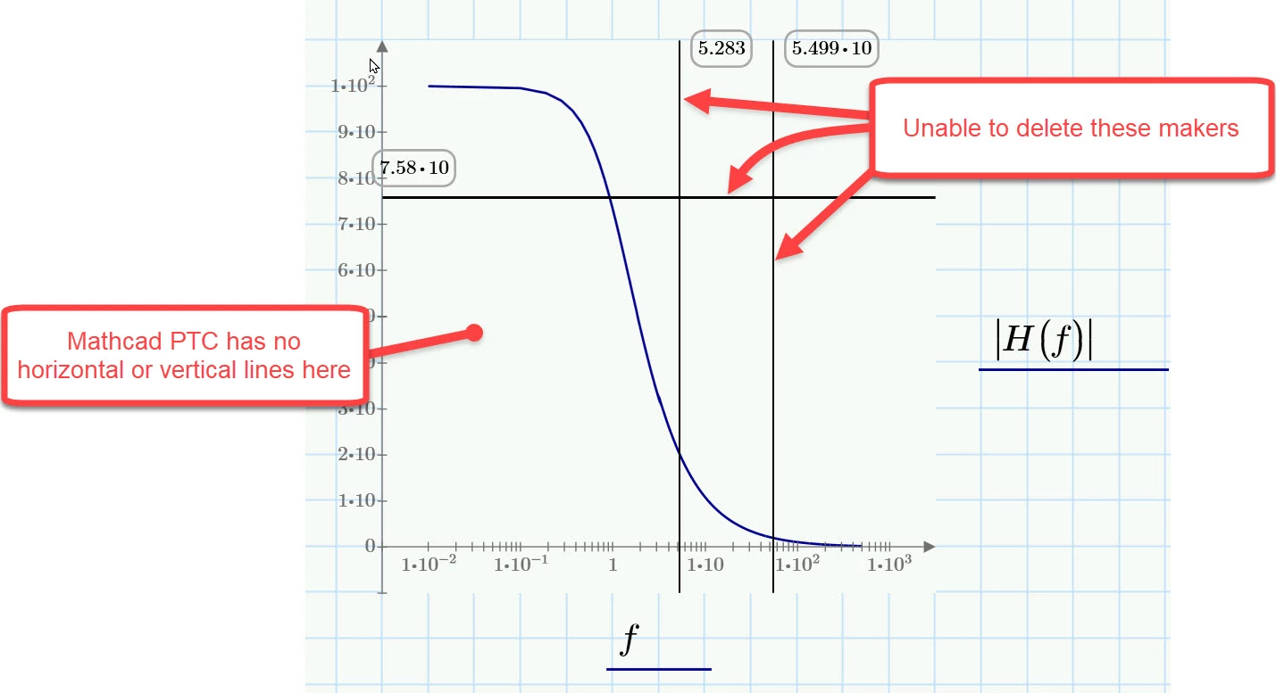

Is it possible to add horizontal and vertical grid lines that are, very often, seen in graphs?   PTC Mathcad's plot has no lines - as default.    I don't see anything in the Plots ribbon that makes these lines appear.
The original Mathcad had the ability to add horizontal and vertical lines onto the graph.
I did find markers that could be added in PTC Mathcad - but, I could only delete one of these makers.  After deleting the first marker the "delete marker" button became gray and therefore stopped functioning.  Now, I'm stuck with three markers on this plot.   I'd like to be able to delete all of these markers at will - if at all possible.
see screen capture.

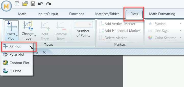

EDIT:  This is how I'm adding a plot to MathCAD PTC:  Plot > Insert Plot > XY Plot
(see second screen capture)

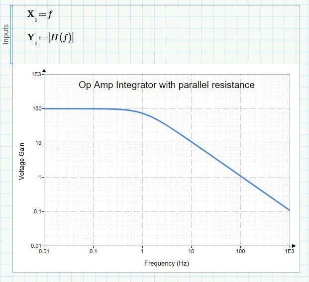

PTC Mathcad Prime actually has two methods of creating XY Plots. One is the Plots tab. The other is the "Chart Component" from the Math tab. Understandably you wouldn't look in the Math tab to create plots, so I get why you might not have noticed it there.
You might find this blog article useful on the differences between the two, and at the bottom there are three videos that go over how to set up a Chart Component, how to format it, and how to do things like export it as an image: https://www.mathcad.com/en/blogs/mathcad-graphing-options-xy-plots-and-chart-components
Of particular interest is that only the Chart Component has options for horizontal and vertical gridlines.

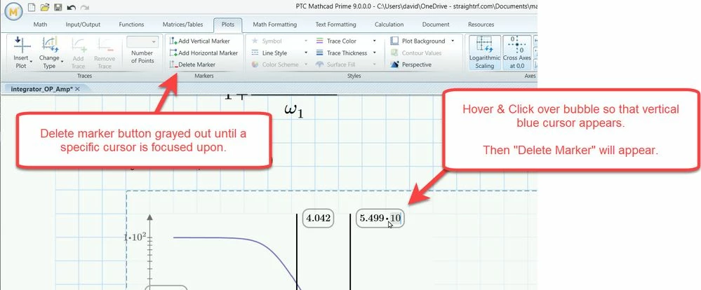

You have to put the cursor at the number of the marker to give it the focus - only then you are offered to delete it (otherwise Prime would not know which marker to delete).
And yes, Primes native plots do not offer grid lines. It also does not offer labels, a secondary y-axis, separate setting of line width and point size, etc.
