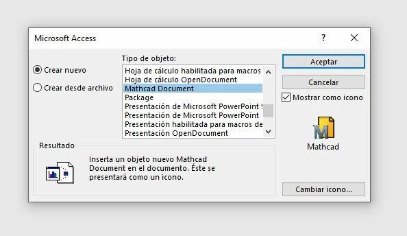

I have been trying to embed a Madcath Prime document in Access 2016, but it has been impossible.
I have the Mathcad 14 version and it does recognise the OLE Objet type, but with the mathcad prime version it does not let me the option to insert it in the Access 2016 form.

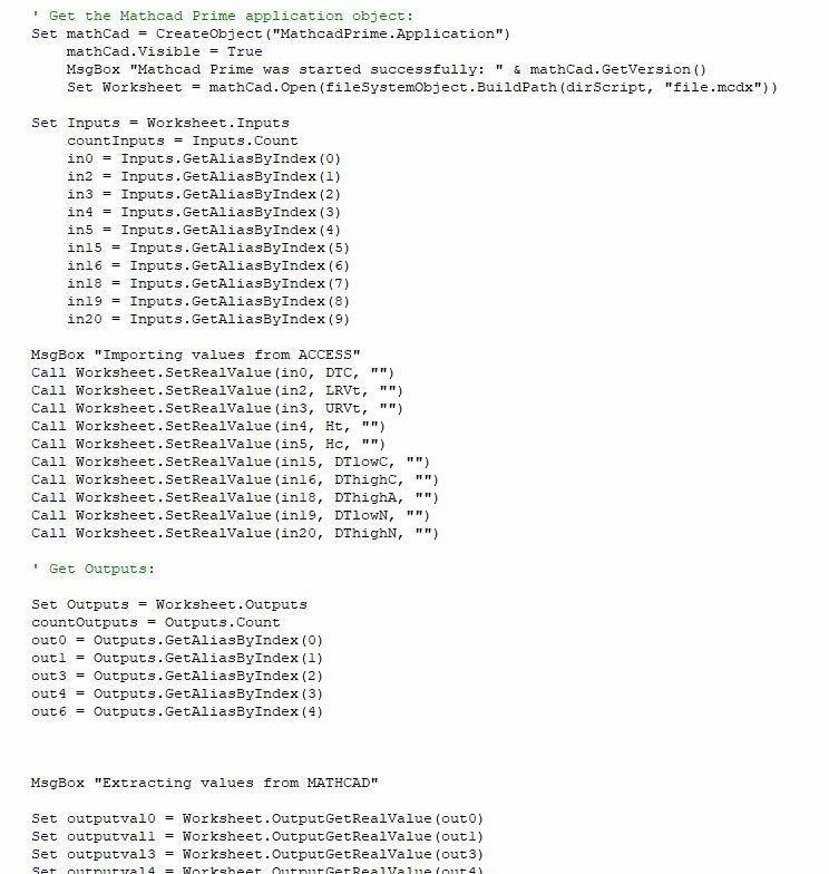

I have created a new object of type "MathcadPrime.Application". but then I had to assign an external address with the file, I can't get it embedded in the Access 2016 form. There are any option wich i dont need to give the external address to the file? (as in Mathcad 14 wich was embeed as an OLE Objet type)
Thanks!!
(This is the VBA code using the "MathcadPrime.Application")
(This image is with Matchad 14)
Best answer by Pablo_PAO
Hi Terry,
Thank U so much for your answerd.
Finally I got it. I inserted the Prime file as a package shell and then i create an objet as a Mathcad.Aplication and use the expresion of the active workbook to write in the MAthcad Primer package Shell.  See the following code with the solution (I mark in bold the important line code):

July 9, 2024
As far as I know you can no longer do this with Prime.  Prime can only be run as seperate instance to open worksheets as you have done to input and export predefined Prime variables.  You can assign VBA modules to buttons on a Access 2016 form.  These VBA assigned modules can run Prime.  There is examples in help that show how.
Again as far as I know you cannot just embed a Prime file.
Can't do more unless you upload the Access and Prime files.

July 15, 2024
Hi Terry,
