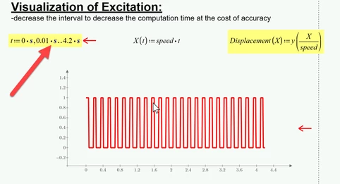

Here you are

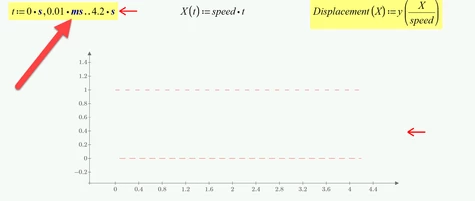

I did no exact timing but it looks to me like calculations need much more time in Prime than in MC15
BTW, omitting the vertical line segments in a step function would be perfectly correct from a mathematical point of view but I understand that its undesirable for an engineer.
There is a simple cure, though.
My suggestion of a step width of 0,01 ms in the range was far too low. It should read 0.01 s which is good enough for the plots.
The range 0s, 0.01ms .. 4.2s forces the plot to be evaluated at 4.2 * 10^5 positions. Mathcad could handle that many points (nearly half a million) but Prime seems to have different limits and it falls back to this strange looking plot where you could not change anything (line style, thickness, .. ) other than the colour.
Changing the range to read 0s,0.01 s .. 4.2 s gives us 421 points which is more than enough for this simple rectangular function. Changing the step width to 1 ms for 4201 points should be OK, too, of course.
Even simple 2D plots always were one of the many drawbacks in Prime and PTC was not able or willing to improve it. You may have noticed that there are not axis labels, no grid lines, the possibilities to customize the plot are much more limited and simple things like changing the axis limits are much more cumbersome.

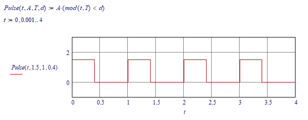

How about:

Luc,
Thank you for the solution. I see it works. I need it to be in the form of y(t)=. I tired to set y(t):= Pulse(t,A,T,d)
But that did not work. How can I accomplish this?
Mike
23-Emerald V
Nov 17, 2019 9:17 PM UTC
You need to fill in values for A, T and d.
Like
y(t):=Pulse(t,1.5,2,0.4)
if your amplitude is 1.5, your pulse duration is 2 and the duty cycle is 40 %.

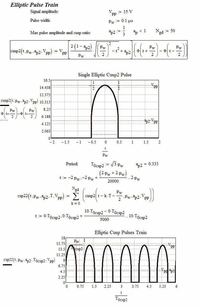

Nov 17, 2019 2:26 PM UTC
mlernst1-VisitorAuthor
Nov 17, 2019 2:36 PM UTC
Thank you for this interesting idea. However, I need it to be rectangular (as proposed by Luc), not elliptical.

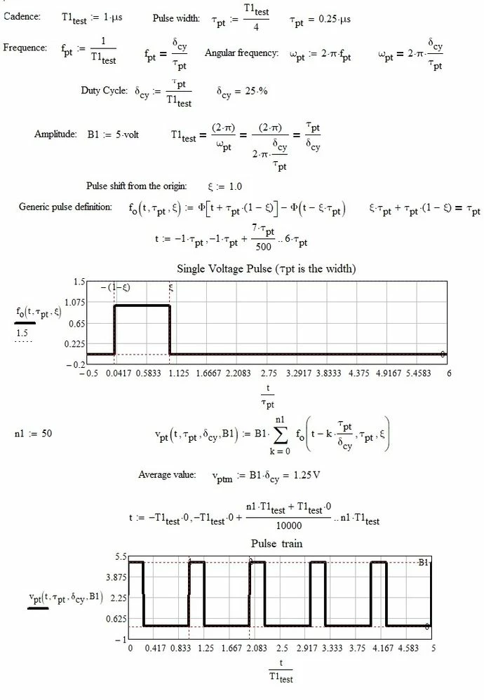

-MFra-
Nov 17, 2019 3:01 PM UTC
Ok!
that's better?

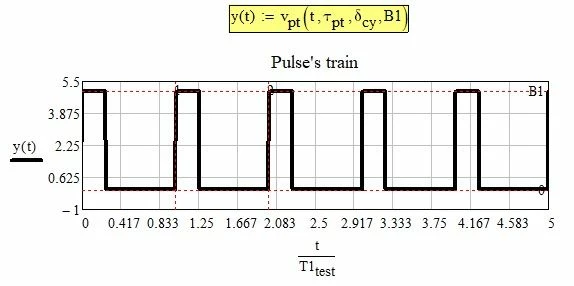

Nov 17, 2019 3:49 PM UTC
it is very simple:
