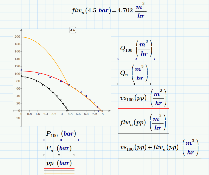

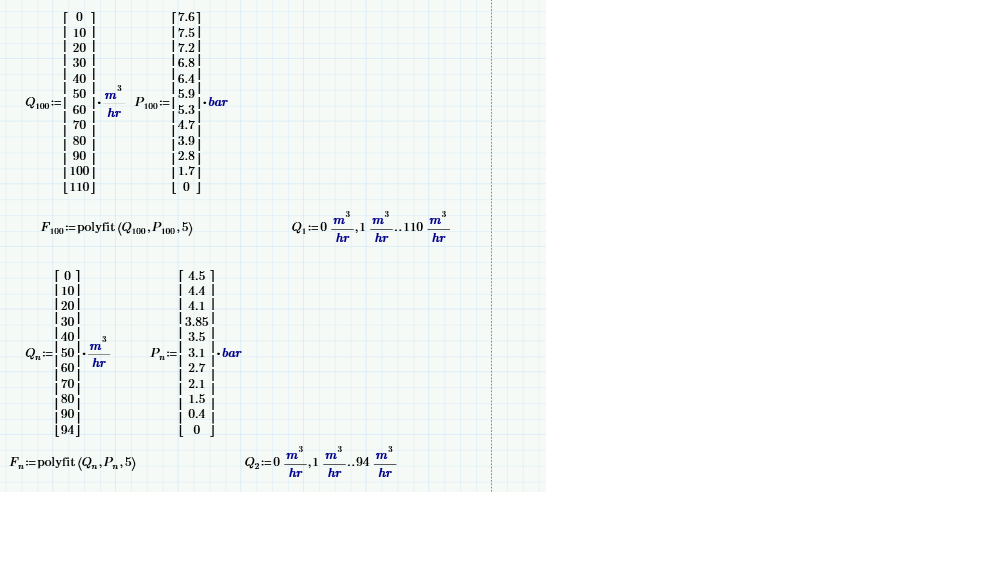

Well, it does, its just not zero as you'd like:

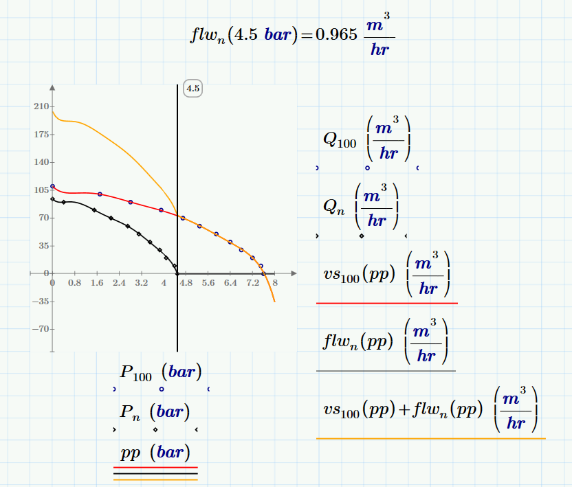

The function "polyfit" does a least-squares development of the coefficients of a polynomial fit, in the case of the graph above a second order polynomial.  A third order fit got me 2.899 m^3/hr, Fourth order got 2.401, fifth got 1.819.  You can do other fits--a spline fit will pass thru points exactly.  Be careful, a seventh order polynomial seems closer to reality at 4.5 bar, butstrange things start to happen:
How close is "close enough"?

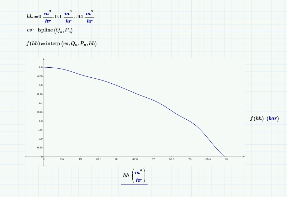

May 9, 2016
Close enough is when i hit all the given marks, and I'm having a smooth curve - if it is even possible. I have just tried lspline, and it is not giving me a smooth curve.
I have tried both l, c and pspline, and I have no clue what the difference is between them.

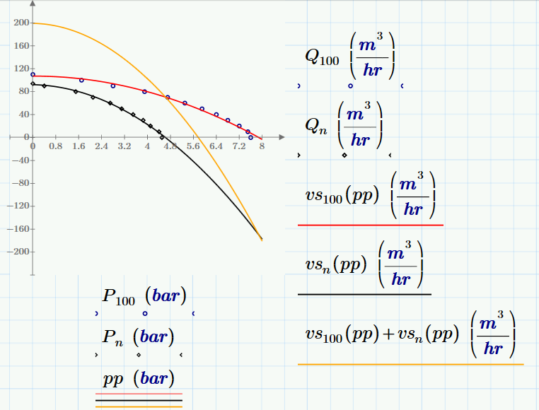

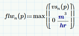

"flwn" is not a regular polyfit "vsn" is.
I guess Fred made it this way because I have to combine them to a system curve.

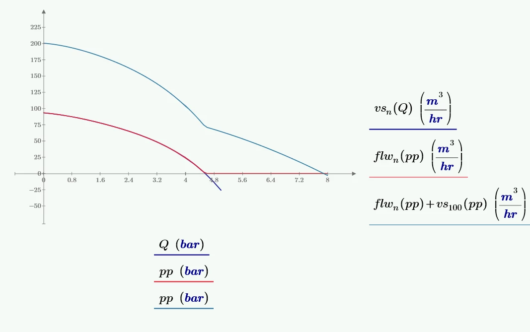

I have attached an image which shows the difference between "flwn" and "vsn", and the combined curve .In the combined curve I would like to replace flwn with vsn, but I can't figure out how to do that. I hope I made myself understandable.
I really appreciate your help.
23-Emerald I
May 10, 2016

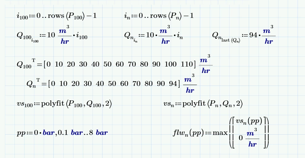

When the discharge pressure gets to 4.5 bar, the pump cannot push any more fluid.  A curve that is built from the data points would predict a negative flow at a higher pressure; I chose to assume that for higher pressures the pump would stop producing flow but would resist attempts to push fluid back thru it, So flw becomes zero if the extrapolated curve is negative:
You can simply replace flw with vsn if you so desire:
But you better be able to explain the negative flow.

I think i managed to make it as i would like it to be.
In the assignment that I am doing, I am supposed to point out excactly where one of pumps will not deliver any flow to the system. In Freds example I can not point out that point because it does not hit 4.5 bar, as it is supposed to if i had made the curve by hand.
If you take a look at the curve that I have made know you can see the difference.
May 11, 2016
I think I see what you mean.
In Freds sheet vsn hits zero at 4.623 bar.
If you chose a fourth order polynomial instead of Freds second order, the hit is at 4.548 bar. Would this 0.05 bar  really be noticeable in a plot? After all, a regression is an approximation anyway (as is a hand drawing). And you don't gain more precision with what you do.

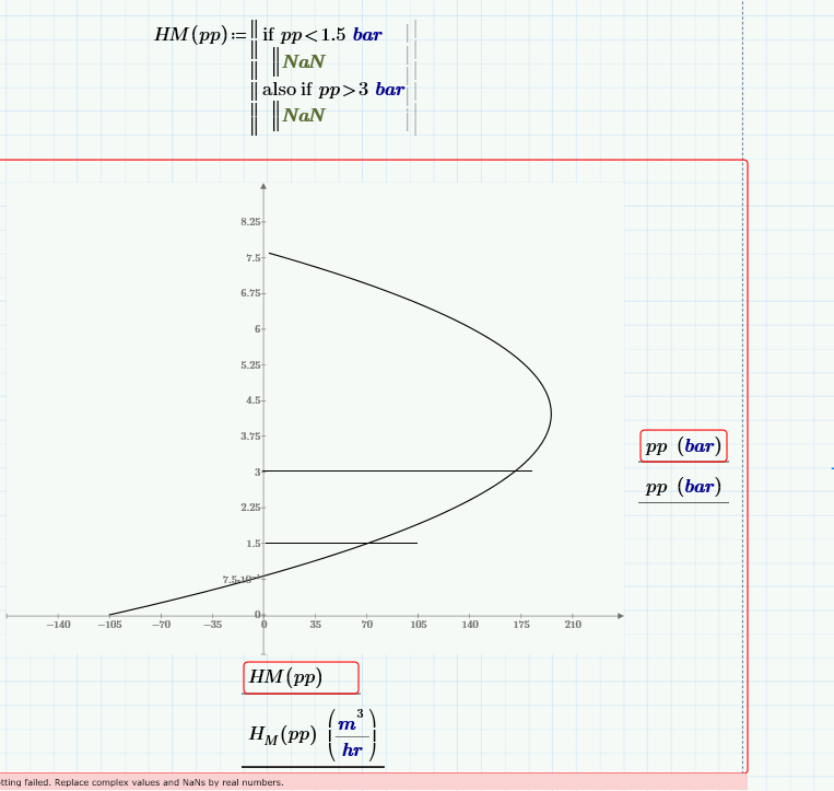

May 11, 2016

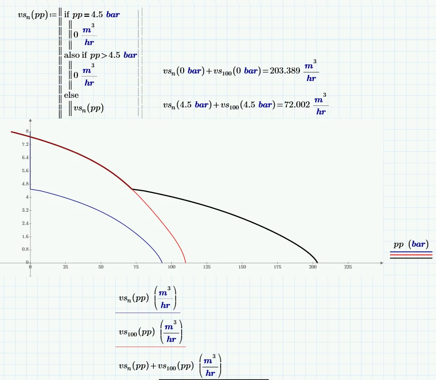

I have tried doing it like this, but I'm not getting the result that I would like to.
I've made to lines in paint, and i would like to leave out everything that is not between these to lines, and I thought I nailed it, but I didn't.
May 11, 2016
What did you expect to see?
You function HM never ever returns a value which could be plotted.
You have to say which value should be returned if pp is in the range from 1.5 to 3 bar!
Probably using soemthing like "else HM(pp)" at the end.
Even better would be
if 1.5 bar <= pp <= 3 bar
     HM(pp)
else
     NaN
