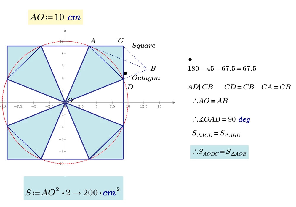

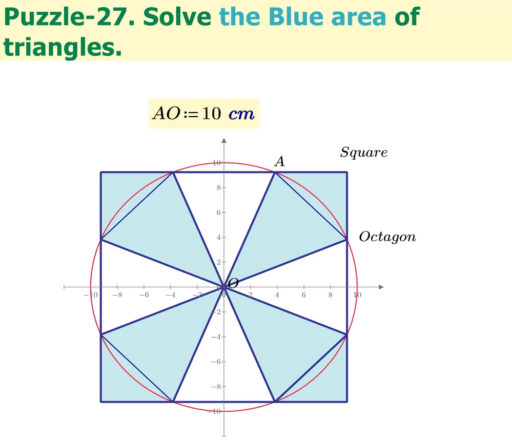

Puzzle 27 Find the blue area.
We have a circle with r=10 cm. Solve the blue area of Octagon and Square make the shape.
This is able to find without trigonometric function or Junior high school knowledge.
But we can use Mathcad to solve.

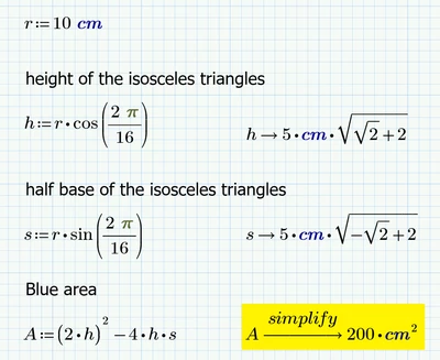

Werner_EAnswer
Jan 12, 2023 11:08 AM UTC
Too easy for Mathcad, even for Prime!

ttokoro
ttokoro21-Topaz IAuthor
Jan 14, 2023 7:42 AM UTC
Without using trigonometric functions.
t.t.

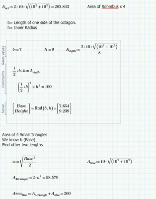

18-Opal
Jan 15, 2023 10:04 PM UTC
Using Solve Box
