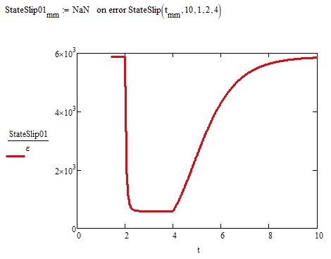

ad 1)
I have not studied the details and so cannot say, why "StateSlip" fails for the first 71 time values with results larger than 10^307. But you can get rid of those erranous values by using the "on error" statement to replace them with NaN's and as you can see the plot of the remaining values seems to look like you expected:
Here you can see up to which value of" t" the function fails
Error tracing leads us to this function call:
