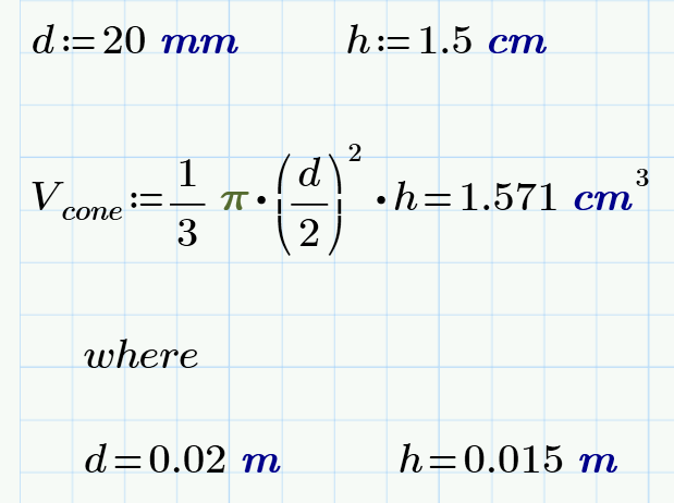

January 7, 2016
Sanket Vaidya написал(а):
2.       Value substitution : Is there a provision (other than explicit keyword) to show substitution of values for each variable in a formula before showing final answer?
3.       Explicit keyword : When explicit keyword is used, Mathcad shows metric values (SI) values multiplied by conversion factors even if the Unit system in Worksheet options is U.S.
But better for all  Mathcads and me

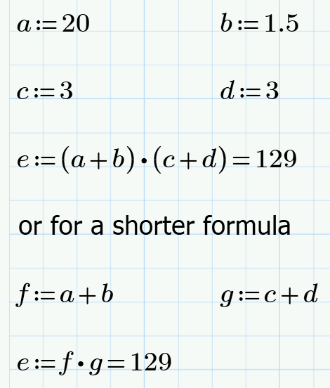

January 7, 2016
1.       Long formulas : Sometimes there are formulas that exceed the width of the page and encroach into the next page. Is there a provision to insert multiline formulas?
Sometimes we can do so:
