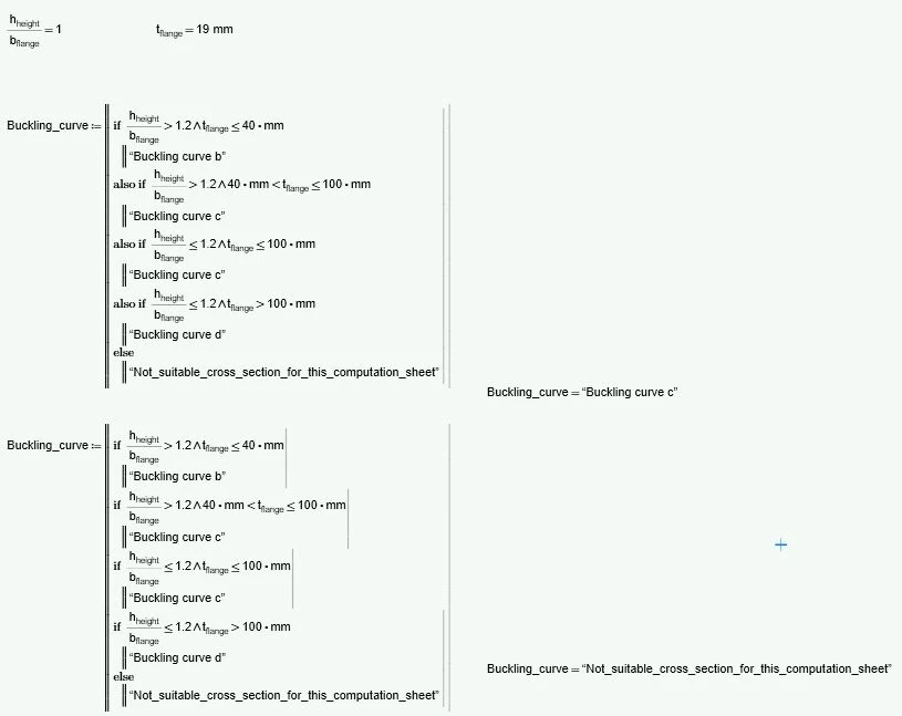

I would like to use simple "if" operators in my computation, just because I'm used to do so with Mathcad 15.
Is it so that I also need to use "also if" statements with Prime?
In some of my computations simple "if" statements appear to work, but for some reason the attached computations result into different results.
Could someone clarify why I cannot use only "if" statements?
terryhendicott
In the second example with only if statements each is treated as an individual statement in turn and execution falls through each statement in turn resulting in the last if-else being the one reported.  The if statement that gives a curve c is simply overwritten by the last independent if-else statement
In the first example (I would prefer to use "else if") the code chooses to execute one of the many alternatives.  The choices should be mutually exclusive covering all possibilities which is what the final else statement does.  The linked relationship between the if - "else if" - else means execution completes when one of the linked portions is true.  If one of the linked portions is false execution passes to the next portion.

It is possible to use only "if" statements as in your second example if you explicitly use the "return" command.
So use
return "Bucking curve c"
instead of just
"Bucking curve c"
And simply type the text in your else-statement as the last program line - without any "else"!
The return statement stops the program and the other commands are not executed. So if no case applies, the last line is the return value.
Don't simply type "return" but use the return command from the menu or type "return" followed by pressing Ctrl-j (a very convenient feature implemented in Prime)

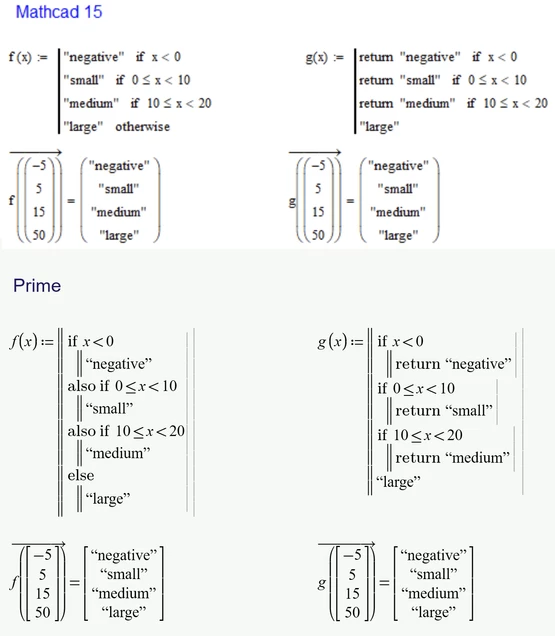

BTW, the behaviour of a program with just a series of if-statements is the very same in Prime as it was in real Mathcad! So I am a little bit confused that you wrote "I would like to use simple "if" operators in my computation, just because I'm used to do so with Mathcad 15."

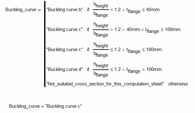

With the Mathcad 15 I had the opportunity to use "otherwise" -operator. See attached figure.

OK, you didn't mention "otherwise" in your first posting.
To achieve the same effect without using return-statements, you would have to use "also if" as you already suspected.
Here' a comparison
