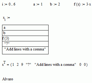

Hi.
Is that an usual thing for define a variable?
Thanks in advance.
Alvaro.
September 25, 2016
Guess no. At least I wasn't aware of that possibility.
23-Emerald V
September 25, 2016
I guess it's equivalent to:
Which I've seen and used a lot, starting at Mathcad 2001i.

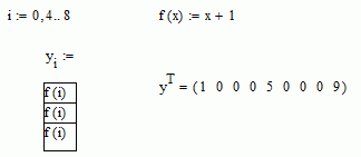

September 25, 2016
Yep.
But for this other? Each element "knows" at which row is living.
Best regards.
Alvaro.
23-Emerald V
September 25, 2016
It is nice, but to be expected.
You define only every 4th element of y, due to your definition of i.
How about this:
