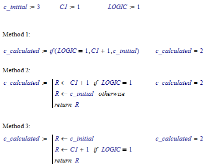

23-Emerald V
There are several ways to do what you want:
