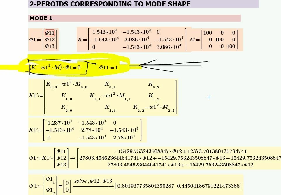

(k-w^2*m)*Phi
Can be expressed as k*Phi=w^2*m*Phi
You can resolve w^2=genvals(k,m).  So w is simply the element by element square root of genvals(k.m).
You can resolve the modes as modes=genvecs(k,m).
Regards
Terry

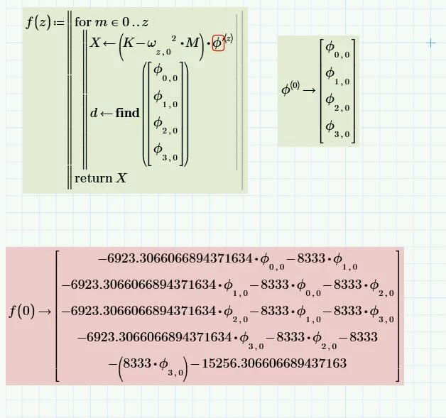

kindly how to get the values of phi (eign values ) like as shown in figure below
August 26, 2018
You can resolve phi as phi=genvecs(k,m).  Each column of phi is a mode shapes.
