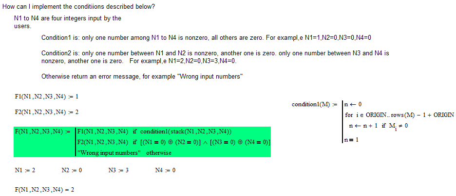

Question of setup a condition for IF ELSE calculation
Hi all, I have a question of properly setup the if condition in Mathcad, would someone help me with the attachment? Thank you!
MJGAnswer
December 3, 2015
How about this?  others may have a better way to handle condition1.

After further consideration, I like this solution better.  It allows you to have better descriptive error text.
December 3, 2015
Here is another way to do it:

Just a general observation, it's often better to use the forms
rather than
as there can be a danger that both conditions a and b could be true, which means you end up getting result y even though you really wanted x.
There's no need for the return statement in the "return z" line above;
I just find it more informative and consistent that way,
Stuart
December 3, 2015
IMO, this is another example where Prime is better than MC15. In MC15 the "otherwise" is attached to the preceding "if". The first "if" is completely independent. Prime changes "otherwise" to "else" (a change not liked by some because it's more like a programming language and less like math notation, but I can live with it), and adds "else if" and "also if", so we can have much more versatile, and better structured, conditional statements.

Stuart, thanks for the suggestion.  I don't do a lot of programming in Mathcad.
Richard, I don't think this statement is accurate:
From Mathcad Help:
"If you use more than one if statement before an otherwise statement, the otherwise statement is executed only when all previous conditions are false."
