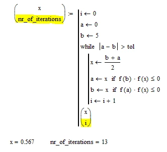

Question on how to count the number of iterations for an Mathcad equation
What command or operation i have to do in order to find the number of iterations performed for solving an Mathcad equation like f(x):=e^x-x       that has in the final the solution 0.5671?
I need to find the number of iterations in order to evaluate the efficiency of the solving method.

Simply return a vector with both value of interest:
tubar1-VisitorAuthor
Thank you very much! It worked for both versions, Mathcad 15 and Mathcad Prime too.

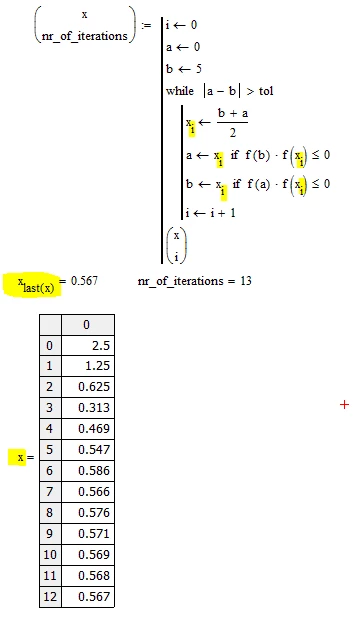

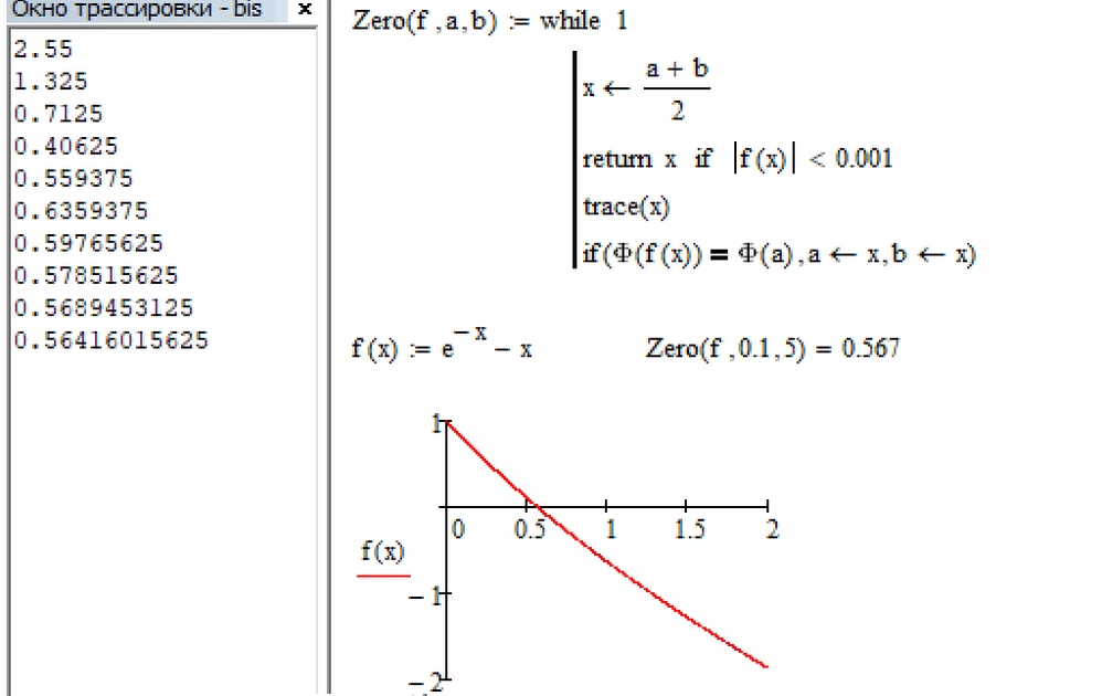

Also, a history of the iterations it is possible to be presented?  For example, in Mathcad 15 exists a function Trace(x) that permits the view of the succesive values of the root x in a Trace Window.
However, in Mathcad Prime I cannot find the history of values of x in a Trace Window. I dont know why.
Prime is clearly inferior to Mathcad in many ways and is missing a lot of functionality compared to Mathcad.
The trace function simply is not implemented in Prime.
To return the history you'd like to see you could store all x-values in a vector and return that vector instead of the last calculated value.
In Mathcad 15 with the trace function:
Thank you. Indeed, the debugging functions are available in Mathcad 15 but Mathcad Prime missed this functionality.
