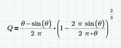

Question with rewriting or solving of isolating a variable on left side of equation.
How can one re-write the equation with only theta on the left. I need to calculate theta when Q is known.
Will this be possible? Q is a ratio variable that rages between 0 and 1 and will be known from previous calculations. I know when Q=0.5 the Theta = PI and when Q=1 then Theta = 2*PI

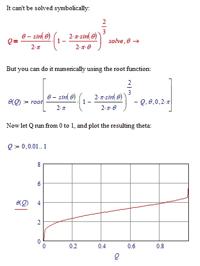

Normally you should attach a worksheet with your problem...
Prime 4 sheet attached.

LucMeekes23-Emerald IVAnswer
December 3, 2019
Jan31-VisitorAuthor
December 4, 2019
Thank you for your response Luc.
I have been trying to solve it symbolically, so that one can get an answer without computational input.
Can you please just indicate why it cant be solved symbolically? (If Q is known)
ttokoro
December 4, 2019
The answer is one or two or three values depend on Q.
