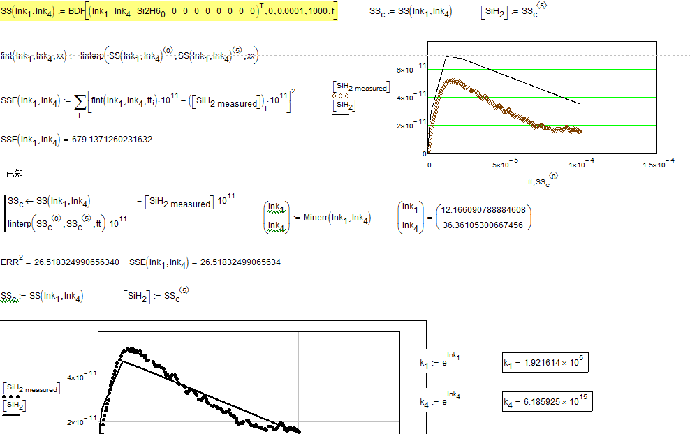

Oct 8, 2014 8:07 AM UTC
thanks for your instruction. it does works! but the fitting degree does not seem as good as that of Radau() in mathcad 11, I will try regulating / adjusting some parameters of BDF()BDF.png
