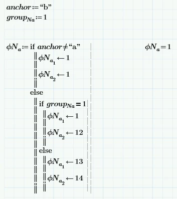

Quick question; Proper way to define multiple vector values
What is the error with the syntax in the attached program? I am attempting to define multiple values of a vector depending on the previously assigned variables. I am expecting the vector to have two rows but only one results.

May 25, 2016 5:06 PM UTC
Post your sheet. From the picture it's difficult to see what is an index and what is a literal.

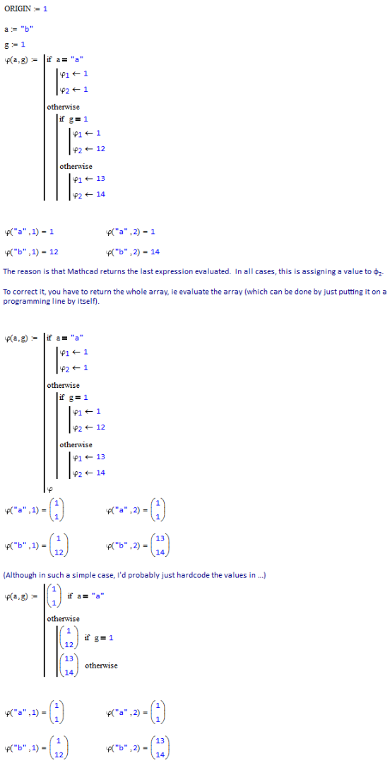

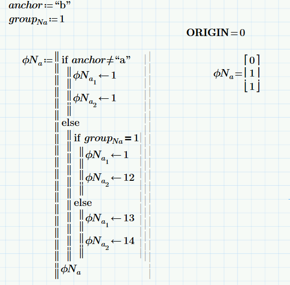

May 25, 2016 5:11 PM UTC
Found the culprit. The function delivers the last statement as result.
Add a last statement that returns the desired result,
such as:
23-Emerald I
May 25, 2016 5:51 PM UTC
Note that Mathcad usually starts vectors and matrices at index 0

May 25, 2016 6:54 PM UTC
I guess it's one of those.....Prime things. This is what Mathcad say about it:
