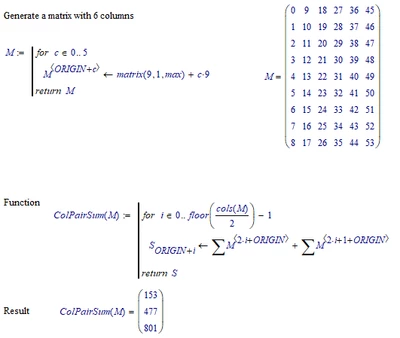

Do you mean something like shown below?
It should work for any matrix with an even number of columns.  The above is written in Prime 7, but the M15 equivalents should work.

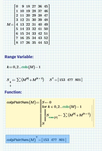

May 20, 2022 1:39 PM UTC
Slightly different implementation that is ORIGIN independent:

May 21, 2022 9:25 AM UTC
Thanks @StuartBruff and @LucMeekes for the suggestions. It works but I realised that there is a slight difference to what I actually needed (I just need to work on a transposed matrix !)
