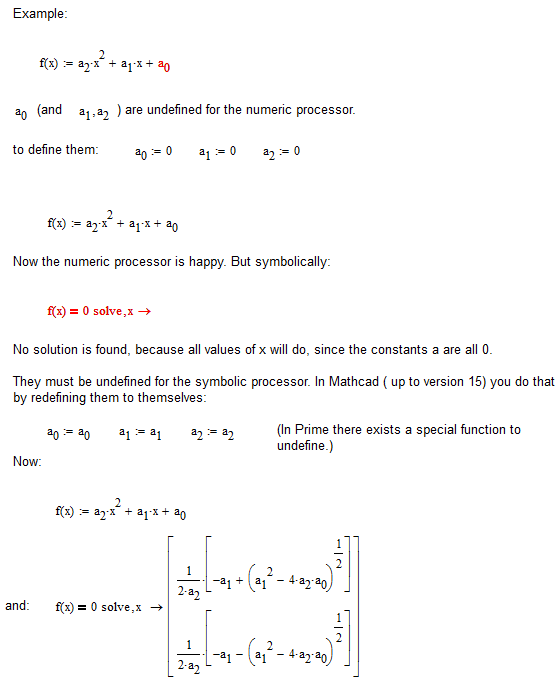

Quiero trabajar con varias constantes, pero simbolicamente.
Quiero trabajar con varias constantes, pero simbolicamente, ejemplo: nu(ν), rho (p), etc. Cómo debo hacer para definirlas y que el programa no me diga que no están definidas.

There is not much you can do against that error. It stems from Mathacds native numeric engine and does not affect the symbolic part (which is the integrated third party program muPad). You may have noticed, that symbolic operations still work despite the error message.
If you use functions, you may consider defining them in such a way, that those "undefined" variables are used as function arguments. See example below.
You would have better done to attach your worksheet or at least provide a screen shot so we better see, what kind of calculations you are doing and maybe there could be a way to avoid that nasty error message. Just telling us that you try to define function nu(v), etc. is not informative enough.
Here the example, hope it helps:
1) The "intuitive" way, provoking the error message from the numeric processor
2) Using the parameters a and b as function arguments, thus avoiding the error at the cost of more typing work

In addition to Werner's reply.

Thanks Luc.
I forgot about the possibility to numerically define the variables and then immediately undefine them symbolically.
Depending on the rest of the worksheet this may have undesirable side effects but it may be a solution for Luis problem.
Here is my example using this trick. The initial numerical assignments have no negative side effects later here, because I redefine the very same variables with the result of the solve command.
