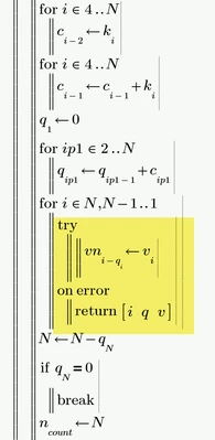

I did not dig into the function "range" to find out what exactly it does, but I threw in a try...onerror statement at the offending position

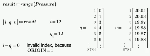

This showed me that the error occurs when i=12.
At this moment qi=12, too and so you try to assign a value to vector vn at position i-qi = 0 and because you set ORIGIN=1 this is an invalid vector index.
Maybe this helps you finding the cause for the problem
EDIT: I tried in MC15 with the file of Ian Ward which I found here and it threw the same error at the same position. Maybe you can try contacting the author? According to dynamassist.com his mail address is(was?)  IanWard@DynamAssist.com
You may also try to download the lastest version (for Prime 10 and above) of DynamAssist from that website mentioned before. It includes amongst others a file rainflow.mcdx which seems to include a modified version of the "range" function you are using. Maybe the bug is already fixed (I did not try as you can do that better yourself).
