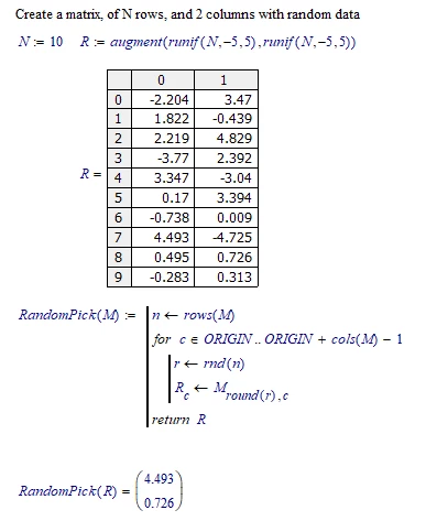

As Fred indicated, there isn't a built-in function, but it's easy to create one, if you trust the built-in random number generators:
I've take that both arrays are the same length, so they can be columns of the same matrix.
I'm also assuming that you want numbers from different rows...

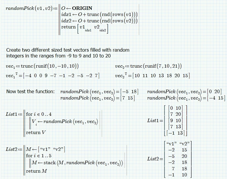

December 19, 2017
Here is my approach with a function with two vector arguments which can be of different size:
