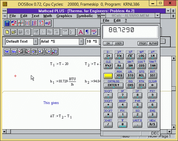

Well, debug mode is somewhere there

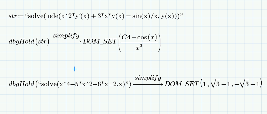

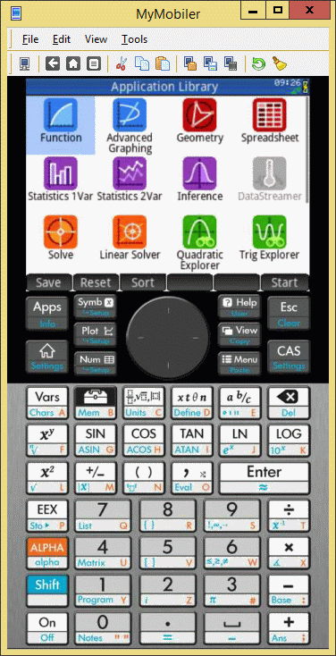

By sheer coincidence, I did suggest before the MuPad choice, that HP (or TI) might be a good option for teaming up with for the symbolic processor.  There were some other quite interesting options floating around at the time, almost any of which would have been better than ending up with a symbolic processor licenced from one of Mathcad's major competitors (although I doubt whether Mathworks would put Mathcad in the "major" category).
Actually, I remember that. In that discussion, I vote for Maxima. Long time ago:
Now:
Mcad icon in those times was ... the HP calc icon!!!.
