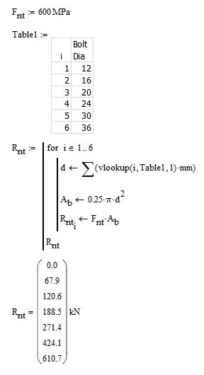

How can I define a range variable when the variables are not necessarily in defined pattern? I have got round the issue in the attached using a lookup expression from a table but can I not define d as a comma separated list? d:= 12,16,20,24,30,36 ? to simplify the expression?

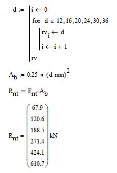

What do you want to do with the range variable once it is created?
the FOR command in the programming toolbar gives a structure:
for <variable> <for each value in> LIST
that will allow you to produce a program as :
regards
Andy
Thanks Andy, I've been trying since you posted but I can't see how I actually use that in my programme? In the end I'm trying to avoid using a lookup table and using a for statement similar to yours! Alas my understanding is failing!

Rather than a lookup table, use a vector.
23-Emerald V
Indeed. In this instance, getting the vector should be a straight forward matter of using submatrix to extract it from Table1.
d:=submatrix (Table1, 1, rows (Table1)-1,1,1)
