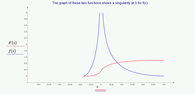

     This worksheet using PTC Mathcad supposed that three points are independently and uniformly chose in a unit square to determine a unique triangle. This worksheet answers two questions:
  1. What can be said about the probability distribution governing the size of the largest angle in the triangle?
  2. What is the probability that the triangle is obtuse?
     This worksheet takes you through the math to determine these answers. To solve you must define the region of integration, and then verify them. It shows you how to graph integration of specific members and integrating bounds. All formulas, calculations, and graphs are provided to aid you in your own calculations.
