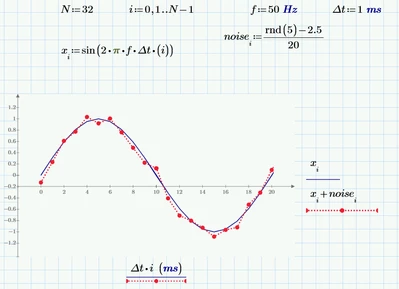

Randomize a sine wave
Hi
Help in randomising a sine wave.
Thanks.
EDIT:
I have put the accepted solution (from Fred_Kohlhepp) as a picture here as some users may not have Prime 7
23-Emerald I
A lot of different ways!  One simple one attached
23-Emerald I
