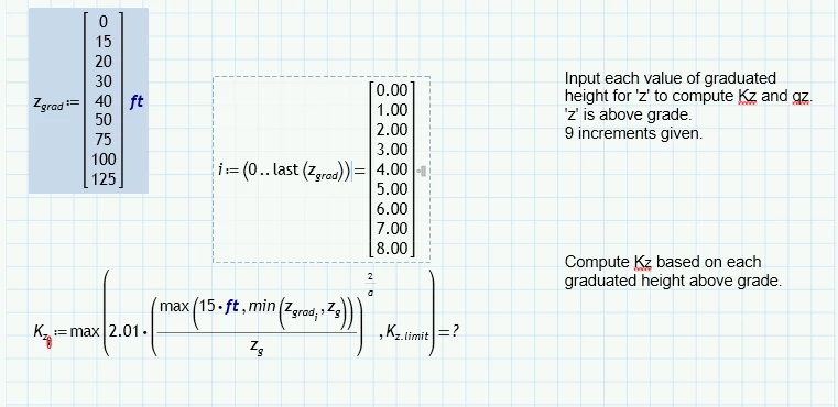

Here are the errors that I faced
"This variable must be an integer".

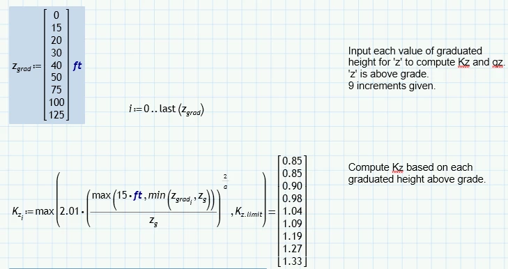

A range variable is used to evaluate other equations.
When the range variable is evaluated, the other equations do not evaluate, for reason that "This variable must be an integer".
When the range variable is NOT evaluated, the other equations evaluate, as expected.
See attached screen shots of equations, one shows the variable evaluated, the other not evaluated.  By request, sample worksheet added.
Question: What am I not understanding about the evaluation, or the NOT evaluation of the range variable?

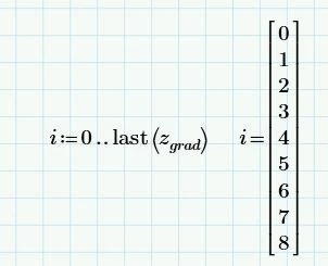

The problem is an equal sign after the definition of the range variable "i".
An undocumented feature of Prime is that if you define a range variable then use an equal sign in the definition it turns the range variable into a vector.
This is a problem if you then use the now defined vector to index a position in a vector.
Capture.JPG is OK as i is a range variable.
Capture2.JPG is not OK as i is now a vector not a range variable.
If you want to see the value of the range variable on creation do this

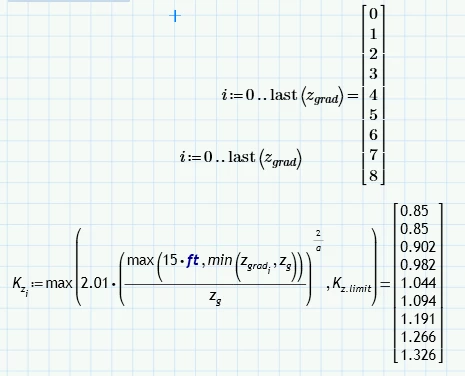

I'm now wondering if there is a means to undo the vector effect?
As a test, I added the equal sign to the range variable and it presented the vector.  I then copied the the range variable down below, but without the equal sign.  With the restatement of the range variable i, equation for Kz evaluates as expected.
See the following and note that the range variable is vectorized with an "=" sign, thus the equation for Kz doesn't work, as previously shown.
Capture - Range Variable Evaluated & Restated.PNG  Next, the range variable is restated, and without the "=".
Thus, equation for Kz is evaluated as shown here.
