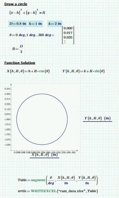

Something like this?
Prime 4 file is attached.

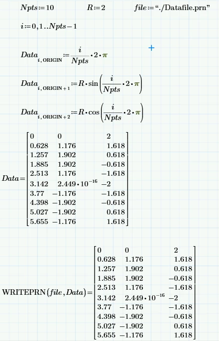

December 6, 2017
For a circular cam it's pretty easy.  This should do it.  Other cams are often piecewise, and I've found no simple solutions other than just stepping through each section.
December 6, 2017
This solution is good also. The augment function is very helpful. Thanks!

December 6, 2017
December 6, 2017
This is what I had in mind. Thank you very much!
