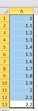

No programming required.
The range definition
x:=1,1.1...2
Translates to Excel as entering the first to items af the range definition in two subsequent cells and select them:
Then you place your cursor this very tiny square:
Press the left-mouse button and move downwards to cells below until the value in a cell reaches 2.
The result is:
The same can be done for a row of cells...or for rows of cells

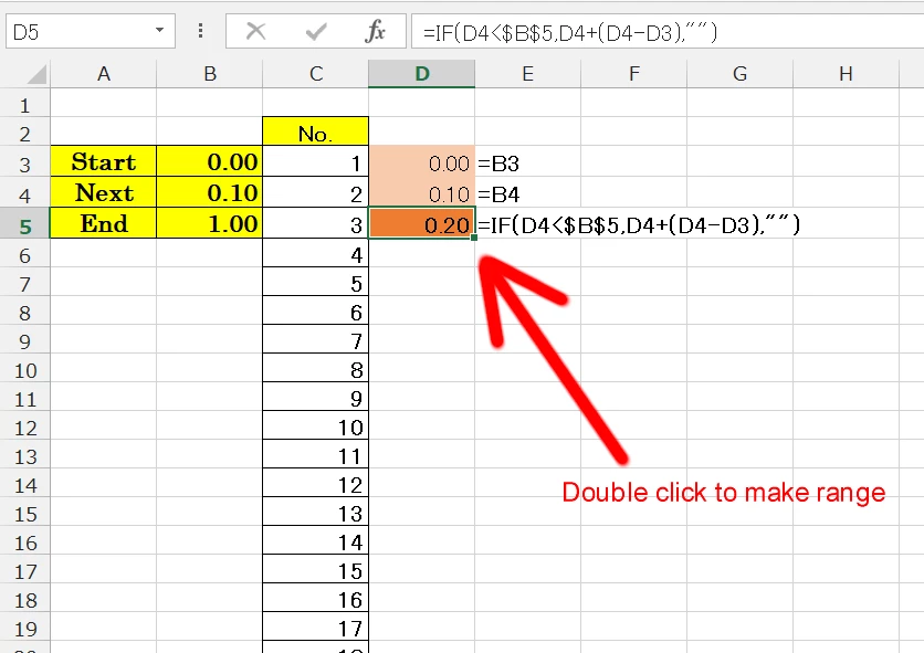

ttokoro
December 5, 2019
t.t.
December 5, 2019
Nice,
But it requires the list in column C. How did you get that?
Otherwise formulated: I see you need a range to construct a range...
