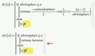

I am encountering the vectorization error that is common when converting old mathcad files to Mathcad Prime 10.  Has anyone updated this sheet for use in Mathcad Prime 10?
Werner_EAnswer
Jan 24, 2025 9:05 PM UTC
Prime isn't using static unit checking (SUC) and as a consequence you have to apply correct units even to zero values:

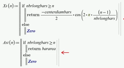

As an alternative you may use the new "unit" Zero (note the capital "Z"!):
Applying these changes make the worksheet functional

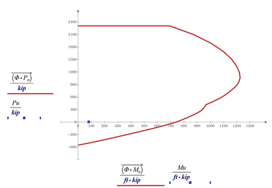

(I edited(deleted) the upper limits of both axis so that all parts of the red trace can be seen.)
Prime 10 sheet attached
