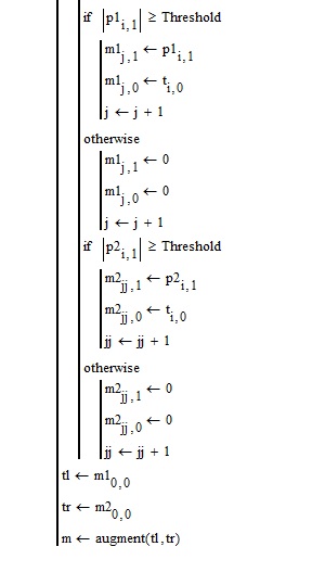

The output of the function “pulse2” is the times that the signal received by the left and the right microphones just reaches the threshold value.
But sometimes (as is shown in the worksheet) the signal never reaches the threshold value and hence there is no output . How can I setup the program that in this situation returns (0,0) value so the rest of my program continue working.

-MFra-
At first glance, since everything depends on the threshold, I made this change where there is a comparison with the threshold. Could it be OK?
payman1-VisitorAuthor
Then it always returns (0,0) even when the signal reaches the threshold value.
Here is my complete program. The error also affect the next function.
