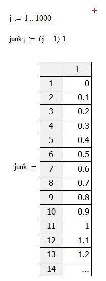

I'm using MathCAD 15 in Windows 7 environment. I'm trying to create a vector using a range variable or at least that's what I think I'm doing. I thought I could set up a similar command sequence in user defined function as below:
But as you can see in my user defined function, MathCAD is not happy with me or range variables don't work the same way in a user defined function as they do in the regular environment.

Just to emphasize the point Luc is making, you cannot use range variables inside a loop in the way you want (and as seems reasonable).  You have to use a for or while loop instead.   You can still define a range variable to use, either inside a program or externally, but you have to handle them differently.

First off, the default start index for a vector is set by ORIGIN, which normally is 0. Apparently you've set it to 1 otherwise junk[0 would have been shown.
To create a vector in a program do:
This one is independent of the value of ORIGIN.

Thanks Guys. I knew had to get around it with just writing a brute force "for loop" in my user defined function. Just found it odd that the range variable method doesn't work inside a user defined function.
