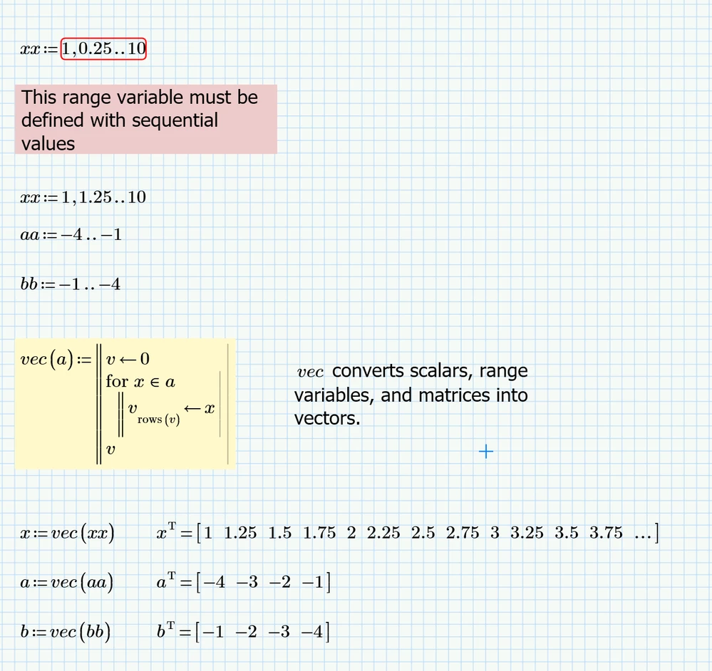

After a while, I am using the Mathcad Prime. Yesterday, I found that the range variables not doing well in case I use step less than 1. Otherwise (for example, 1.25, 2.1, etc. are OK).
Essentially, I want to specify step < 1>
I would like to how to get around this issue.
PL. Help.

The 3-place Mathcad range operator does not take the step size.  It takes the first value of a sequence, then the second value in the sequence, and then the bound (usually final value) of the sequence defined by the first two values.   The 2-place range operator assumes that the second value is sign(last-first).
Set the second value in the range variable to the first value plus the step value:

Thanka a lot for the reply.
I got it.

Sample attached, along with a version of vec that flattens nested arrays.
