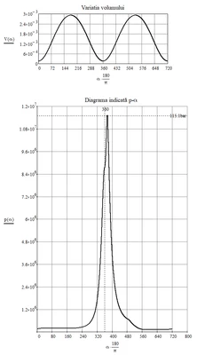

As per the original post.
Can someone help me to convert this file in mathcad 2020(mcdx)?

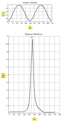

See if you can open the attached file.
One remark: The files uses units throughout and so I am wondering why the diagrams don't make use of them.
Instead of
I would use
EDIT: The new Prime (also applies to the current versions) is way not as capable as good old Mathcad. Many features are not available in Prime and so the converted file may need some rework and workarounds, E.g. simple things like Plot labels and captions are not implemented in Prime. You have to make your own by creating text regions and placing them manually at appropriate positions - no, thats not a joke, PTC is seriously giving this advice.
For your convenience I also attach a pdf of the original file so you see how things should look like. Page breaks may differ as I did not "print" to letter sized "paper".
