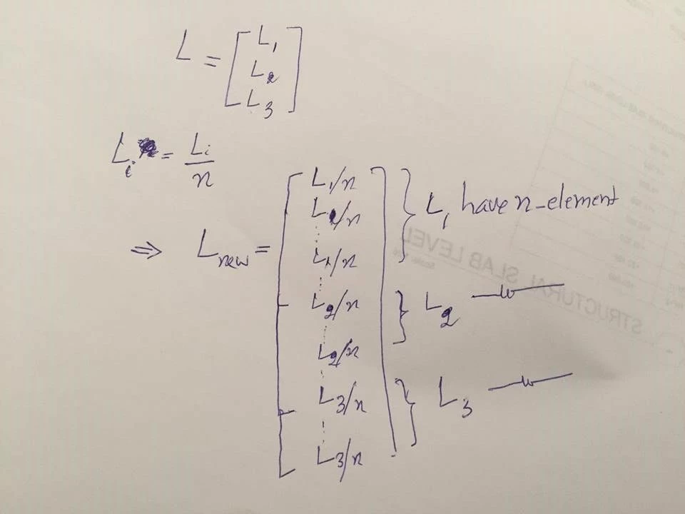

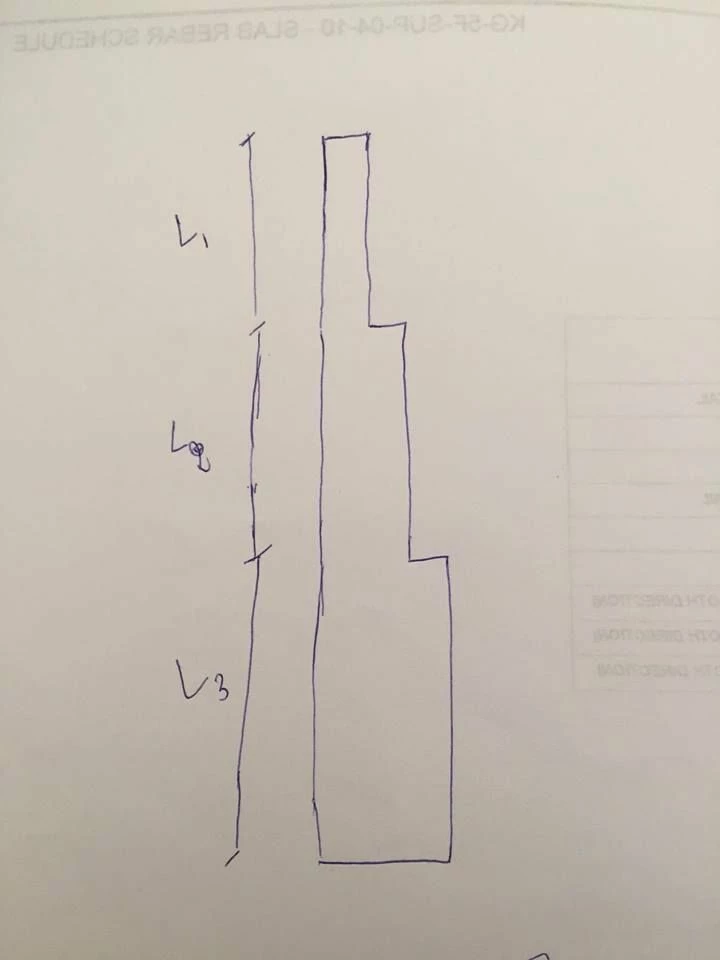

Dear Everyone,
How can I Create New Matric by divide Matric element by n-element (as attachment)?
Many thank for replying.
Best regard
PhearunInitail ElementInitail ElementPurpose of QuestionPurpose of Question

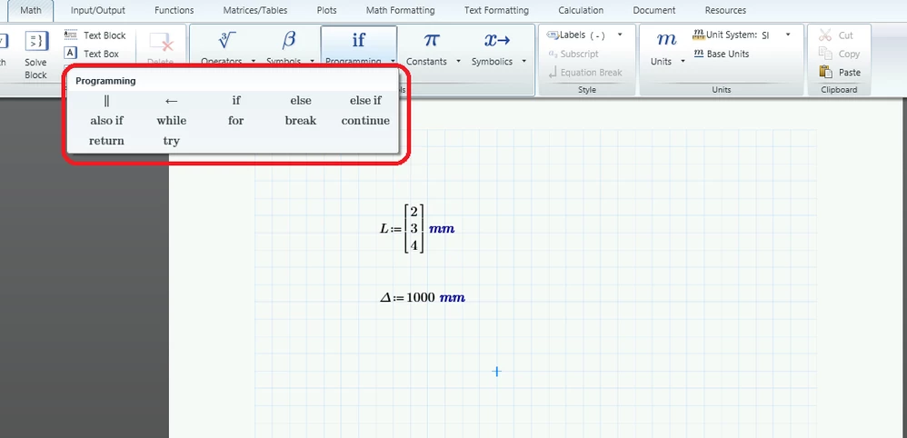

Yes, the delta is segment-Length-provided-user to find number of segments of elements L. You can ignore it.
So why did you post it?
Turn to original.

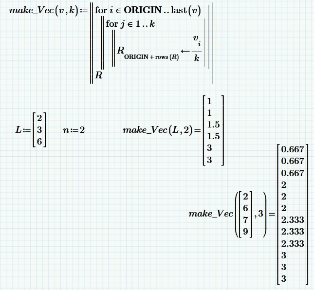

Which is still not clear as to what exactyl you need. Do you mean that n is the very same value for all elements of L? Then this should be what you are looking for:
9 replies
March 16, 2018
You would have to write a function which, in a loop, creates the new vector.
