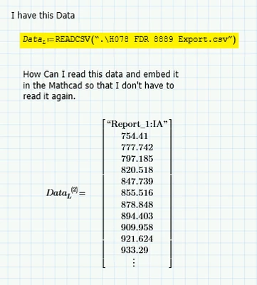

Hi
If you want to do it with Prime only:
Select data in Excel without the headers and Ctrl+C.
In a prime document locate cursor in space and Ctrl+V.
An input table will be created without headers.
Copy/Paste the headers one by one.
See enclosed file
Cheers
Terry
terryhendicott
Jul 10, 2024 2:42 AM UTC
Enclosed is a file with one matrix data that holds all you data from the csv file.
1)Open Excel and read the csv file, select all the data and Ctrl+C  to copy
2)Open Mathcad 15 and set an equation data=, then Ctl+V to paste matrix into right hand side.
3)convert mathcad 15 to Prime.
terryhendicott
Jul 10, 2024 4:39 AM UTC
Hi
See enclosed file
Cheers
Terry
