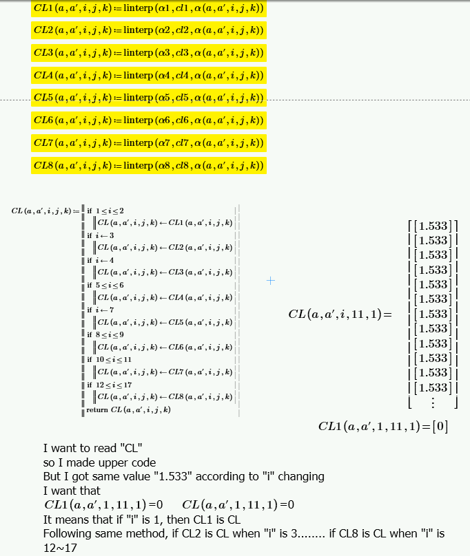

read data in case of each condition
I finally success to calculate my work by using "vector"
SO I want to say "thank you" for all people that they helped me.
After calculating, I did read data "CL" by using "if" in case of each conditions.
I got strange values that I couldn't understand.
so I writing this site about my problem after truble.
could you give me advice for me?

My advice is to read and understand how to use the indexes in arrays and vectors.
