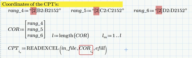

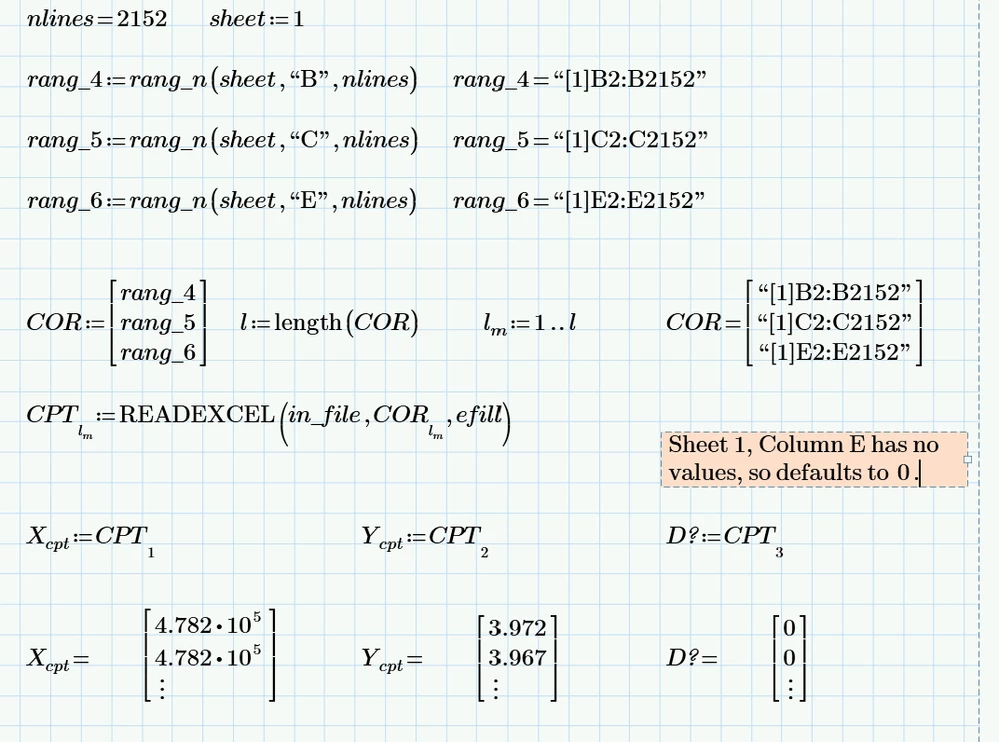

Is the Excel worksheet up to date?  You call Sheet 2 in your Mathcad worksheet, but in addition to the lack of Column D, there is no Sheet 2 in "Total Original Location.xlsx".
I modified your Mathcad worksheet to construct the range from the sheet number, column letter and number of lines; I also modified Sheet 1 to include a Column D (scaled copy of Column C).  I didn't see any errors when using Sheet 1 for all valid ranges.  I then changed rang_6 to point to the empty Column E and got a vector of zeros (as expected from an empty column).

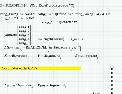

Missing your Prime file. Hopefully stripped down just showing the reading of the data and the display of the unexpected zeros
Not sure how the pdf you posted should be of any help here.
P.S.: Your Excel sheet only contains three columns of data (A,B,C). Hope you did not try to read columns D and E !??
Oct 20, 2024 4:14 PM UTC
Sorry I attached the wrong sheet
Oct 20, 2024 4:50 PM UTC
There is no sheet2 in the Excel file you posted!
As already written before it contains just one sheet with three columns of data (X,Y,Z values) - nothing more.
So trying to read from the second sheet obviously must fail
