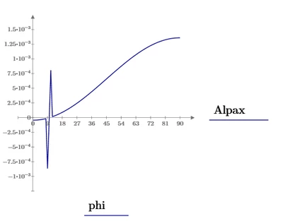

This results in a curve like this: I have found no way to correct the exponents on the two extreme points. The curve should be smooth.

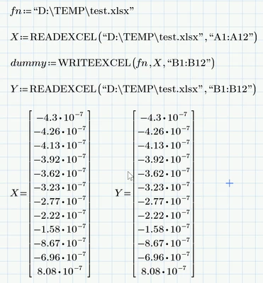

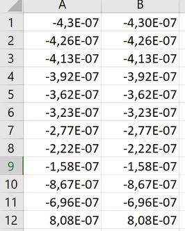

When I copy your “Before” data into an Excel file in column A, read it into Prime 11, and then write it back to column B with WRITEEXCEL, the data does not change at all. Neither in Prime nor in Excel!
Prime:
Excel:
So what's your problem?? What process does your cryptic “before” and “after” refer to, and what does this all have to do with the graph shown and the peaks you mentioned?
